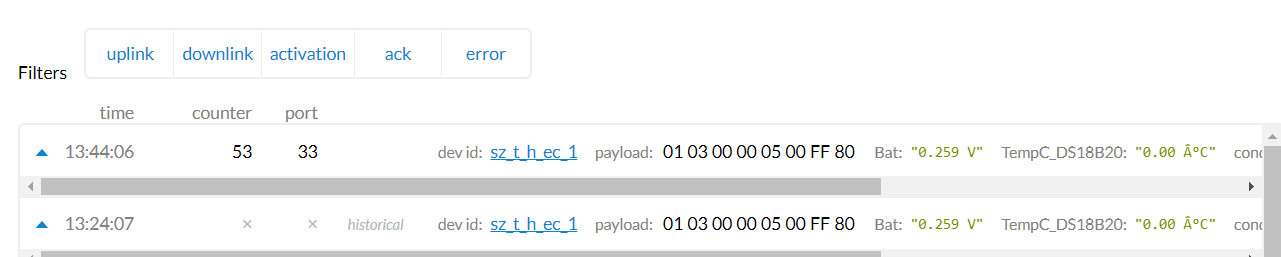

However I am trying to integrate my sensor LSE 01 Humidity to THE things Speak, or My devices, and it doesn’t show any information in the platform integrated.
 ![image](https://www.thethingsnetwork.org/forum/uploads/default/original/3X/b/a/ba8ecb9fefc6b72e7592b735f2a4a1d4ef1732a2.png)
This is my decoder code for my sensor: Doesn’t send information to any platform

The decoder will decode but it seems you are trying to find a way to get the data out of TTN and on to somewhere the data can be displayed.
In that instance, Integrations are where you need to look:
[https://www.thethingsnetwork.org/docs/applications/index.html](https://www.thethingsnetwork.org/docs/applications/index.html)
Please bear in mind that, a, v2 will close by year end and b, there is no myDevices in v3 and we don’t know when or if there will be.
