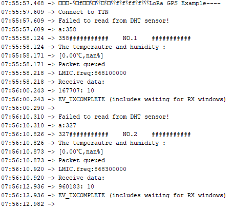

Hi @cslorabox,
here is the output.
![test%20arduino](https://www.thethingsnetwork.org/forum/uploads/default/original/3X/d/1/d127f4b4410ae444b295e24b38efb6b2aecb99f8.png) .

**Author:** ![cslorabox](https://www.thethingsnetwork.org/forum/user_avatar/www.thethingsnetwork.org/cslorabox/32/35697_2.png) [@cslorabox](https://www.thethingsnetwork.org/forum/u/cslorabox)\
**Post date:** [December 5, 2019, 4:11am UTC](https://www.thethingsnetwork.org/forum/t/dht11-cannot-read-temp-and-humidity-on-lora-shield-gps/32383/6 "2019-12-05T04:11:23Z")
</div>
you seem to have commented out all calls to dht.begin()
