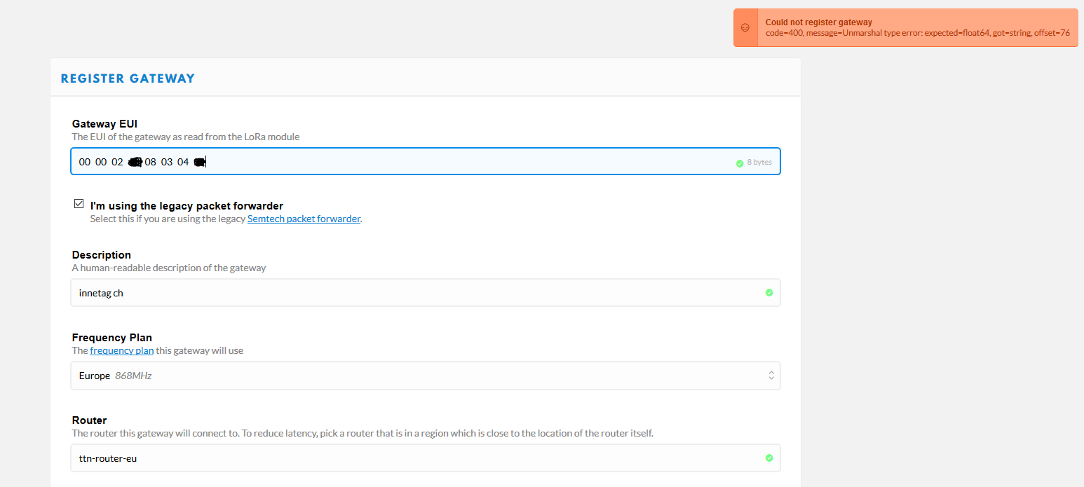

Sounds all reasonable. I redeployed the forwarder to my Kerlink.
The EUI marked in the logfile was only 4 bytes long. I used that one from local\_conf.json.
Now the TTN-Console fails to register the gateway: ![](https://www.thethingsnetwork.org/forum/uploads/default/original/2X/a/a5eca44f88d7fa275853cfc66dc147ecc98b6c94.png)
<div class="post-metadata">
**Author:** ![maus](https://www.thethingsnetwork.org/forum/user_avatar/www.thethingsnetwork.org/maus/32/4922_2.png) [@maus](https://www.thethingsnetwork.org/forum/u/maus)\
**Post date:** [June 14, 2017, 1:08pm UTC](https://www.thethingsnetwork.org/forum/t/firewall-settings-and-gateway-id/7885/7 "2017-06-14T13:08:59Z")
</div>

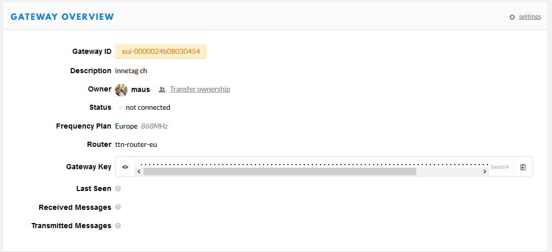

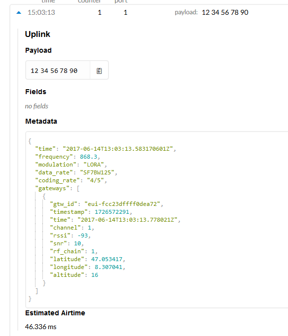

Ok. The error was because of the empty position data (latitude, longitude). It finally worked and I could add the gateway.
I then have joined a node and sent some message. The weird thing is, that the messages are coming through but the gateway status remains as `not connected`
 ![](https://www.thethingsnetwork.org/forum/uploads/default/original/2X/8/89bf32060fb9e802bc449461a8474b12c6bbdda5.png)
 ![](https://www.thethingsnetwork.org/forum/uploads/default/original/2X/f/fc92943c3f48c6977fd1f20493e40ceccdbe8e97.png)
**Author:** ![jpmeijers](https://www.thethingsnetwork.org/forum/user_avatar/www.thethingsnetwork.org/jpmeijers/32/44875_2.png) [@jpmeijers](https://www.thethingsnetwork.org/forum/u/jpmeijers)\
**Post date:** [June 14, 2017, 2:54pm UTC](https://www.thethingsnetwork.org/forum/t/firewall-settings-and-gateway-id/7885/8 "2017-06-14T14:54:42Z")
</div>
You can see from the two screenshots that the gateway id’s are different. So either another gateway is receiving your packets, or your real gateway EUI is different.
Registered as: `0000024B08030454`
Received by: `FCC23DFFFF0DEA72` (Located in Luzern)
_(yes, I just typed those over from your screenshots)_
