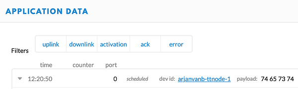

This works for me, though it defaults to port 0:
```plaintext
curl -i -X POST --data '{"dev_id": "arjanvanb-ttnode-1", "payload_raw": "dGVzdA=="}' https://integrations.thethingsnetwork.org/ttn-eu/api/v2/down/arjanvanb-app-ttnode/arjanvanb-http-ttnnode?key=ttn-account-v2.kFd<redacted>Vi_il4
HTTP/1.1 202 Accepted
Server: nginx/1.13.7
Date: Wed, 01 Jul 2020 10:20:50 GMT
Content-Type: text/plain; charset=utf-8
Content-Length: 0
Connection: keep-alive
 ![Application data](https://www.thethingsnetwork.org/forum/uploads/default/original/3X/7/d/7dee7c8e4a8ab3bab21907256434eb9197c1fc7e.png)
⚠ Port 0 is reserved for MAC commands without an application payload, so you should also include `"port": 1` or another value in the JSON data. Not doing so, it seems TTN will (currently) use the same port that was used for the uplink. But that’s undocumented behaviour, so surely it’s better to be explicit instead.
Note that the full downlink URL that you need is also in each uplink message that is posted by the HTTP Integration. So, you should see that on RequestBin.
