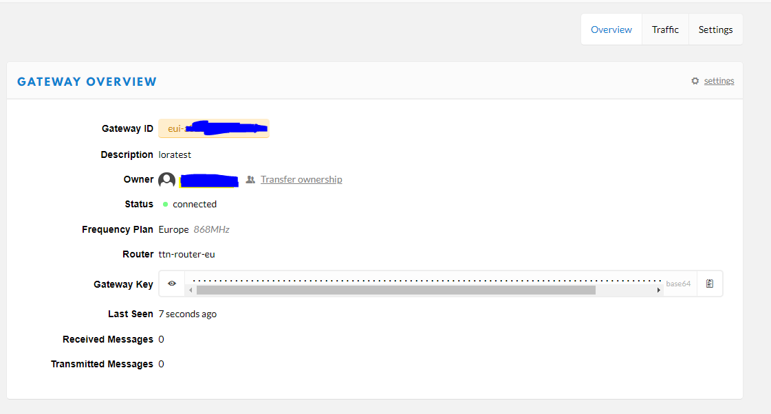

I have already created my own ESP-1ch-Gateway-v5.0
Gate status says connected. I can see it as blue on ttn map.

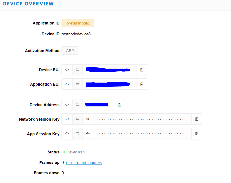

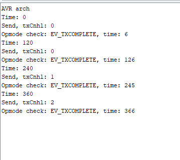

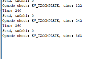

Now i am trying with the node but i get this in my serial monitor:
 ![image](https://www.thethingsnetwork.org/forum/uploads/default/original/2X/4/47af08e84ba6e2747fdc02b7cb5048b6f6d66db9.png)
It says Status “never seen”.

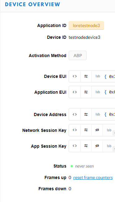

I rechecked multiple times all keys and i recreated new application.
 ![image](https://www.thethingsnetwork.org/forum/uploads/default/original/2X/0/06596398d56343b058b5713779f8044ce7fa6922.png)
Any suggestion?

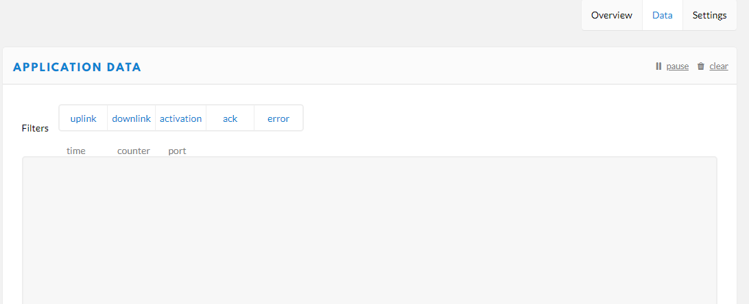

nano rfm95
using nano-lmic-v1.51-F.ino example
it is empty app data …
 ![image](https://www.thethingsnetwork.org/forum/uploads/default/original/2X/0/0510b1b1fd4b9086570cd051718ceae9a6a3fd9d.png)
not sure what exactly u wanna see?
<div class="post-metadata">
**Author:** ![BoRRoZ](https://www.thethingsnetwork.org/forum/user_avatar/www.thethingsnetwork.org/borroz/32/44234_2.png) [@BoRRoZ](https://www.thethingsnetwork.org/forum/u/BoRRoZ)\
**Post date:** [May 23, 2018, 8:07pm UTC](https://www.thethingsnetwork.org/forum/t/hello-world/14461/4 "2018-05-23T20:07:54Z")
</div>
- reset frame counters
- leave application data window permanent open
- restart node
- take screenshot
if the node is OTAA you should see it in the application window trying to join

I believe he’s using ABP from one of the earlier photos, which at least removes the possibility of copying in DevEUI as MSBF instead of LSBF. With that said without knowing if the Dev Address and Nwk and App Keys are in fact actually correct and in the correct format for the code he’s using it’s a little bit of a hit or miss.
@mojnetwork What channel is your Single Channel gateway listening on? Just because the node says it’s successfully sent the packet on Channel 0, 1, and 2 doesn’t actually mean it was received by your gateway.

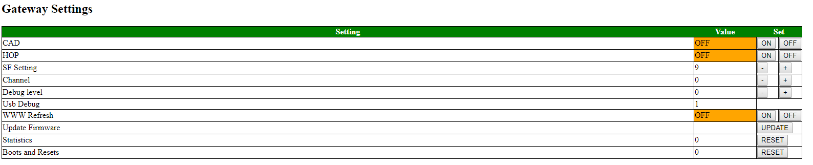

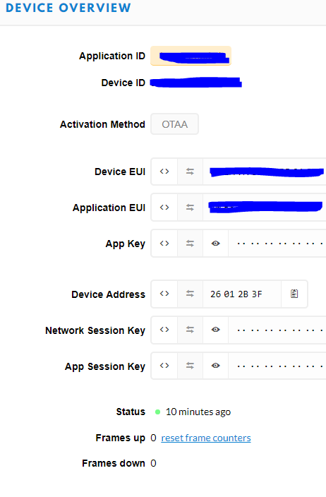

My Gate Settings.
![image](https://www.thethingsnetwork.org/forum/uploads/default/original/2X/d/dd2b65fda1b9a5f22f98aa56ac4fd4a921143700.png)
I used Isb format.
![image](https://www.thethingsnetwork.org/forum/uploads/default/original/2X/d/d4b03abf9580f8db9d6b313f20cf398400c3d92d.png)
I have also:
“reset frame counters
restart node”

If you are using ABP the Device and App EUI does not matter (also helpful to just comment it out) in your code which is why I referred to the LSB vs MSB issue before. Also If you are using LSB for your Device address and your Network and Session keys there is a problem as the LMIC code you are using as far I know and most implementations are MSB for those instances. If you want to use OTAA and are testing that you need to set your device as such and then you can worry about the LSB vs MSB issue with the EUI’s.

@mojnetwork
Just a note, the code you are using for the node the Nano LMIC library is set to use SF7 by default and your gateway is looking at SF9.

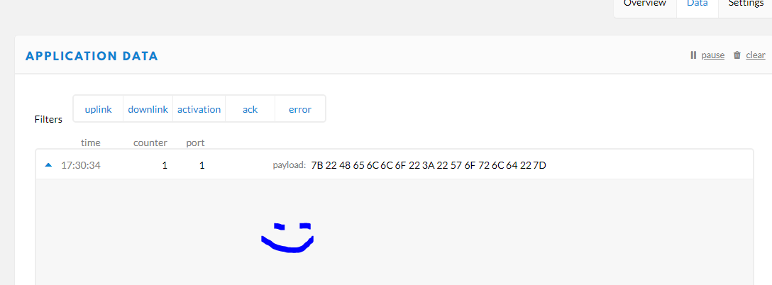

![image](https://www.thethingsnetwork.org/forum/uploads/default/original/2X/7/752d9a0a9d32d48c266cb96c8f33fab7bb3dc0d9.png)
🙂 i got my first msg
1. i changed sf9 to sf7,
2. Device:
ABP
Device EUI Isb
Application EUI Isb
Device Address msb
Network Session Key msb
App Session Key msb
I would like to test also OTTA version not sure if i just comment somestuff(NwkSkey, AppSkey, DevAddr) in the code?
OTTA Device overview has 3 keys Device EUI, Application EUI and App Key(this one is missing in code)… is there any example of the code for OTTA?

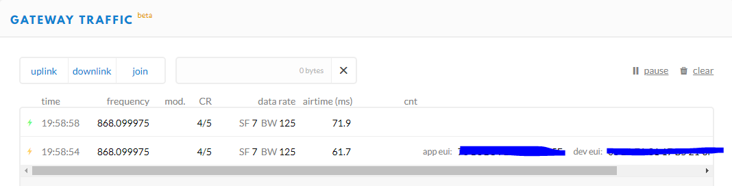

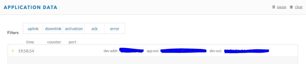

So i am trying with this OTA code(link u provided): matthijskooijman/arduino-lmic
Gateway
 ![image](https://www.thethingsnetwork.org/forum/uploads/default/original/2X/4/47903c008a294d87c2136ede1adec05f9bc38e03.png)
Device Data
 ![image](https://www.thethingsnetwork.org/forum/uploads/default/original/2X/8/80d2e785380d21535e599fa0920e0135c7098264.png)
 ![image](https://www.thethingsnetwork.org/forum/uploads/default/original/2X/3/39e2119d2a1560312ef22c78f2afa68afefb1411.png)
Arduino Serial Monitor:
 ![image](https://www.thethingsnetwork.org/forum/uploads/default/original/2X/4/45b0e0cf58e47f5f159889526f6c59b38d53bc3d.png)
Is this ok? I mean Device App Data status is orange “activation”?
And here it hangs …i am not getting any data.
I suppose code should be sending “hello world” msg in intervals(it is not doing that).

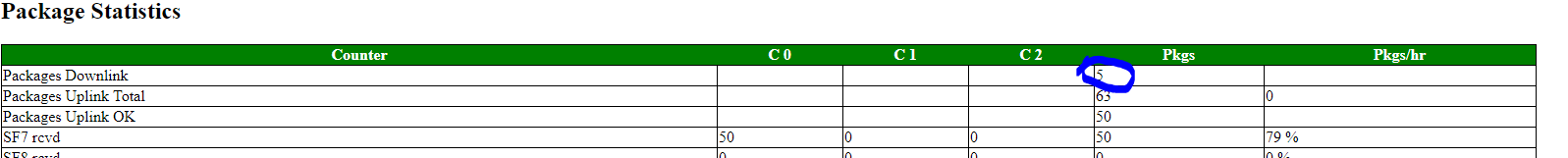

I see that Gateway gets some DL packages…

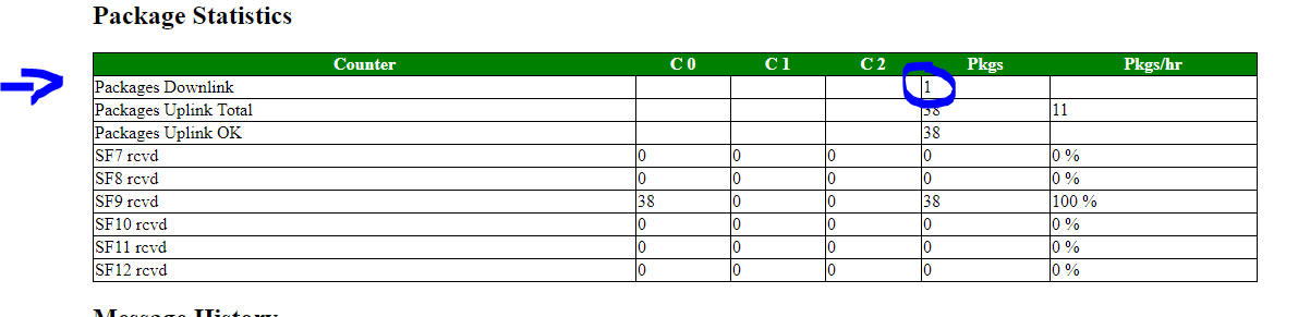

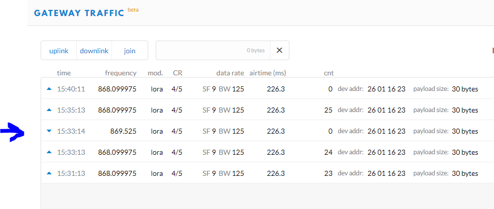

I can see i my Gate Traffic that simulated download package has been sent.
![image](https://www.thethingsnetwork.org/forum/uploads/default/original/2X/e/ed5047e5efd020dd5cbcf98f9eccfd0066056da0.png)
I have received this package in my Gateway
 ![image](https://www.thethingsnetwork.org/forum/uploads/default/original/2X/b/b39c12eefc88f3c8b321ce9bf6d9cc45fc104503.png)
I did not get any notification from my Node in my serial monitor.
