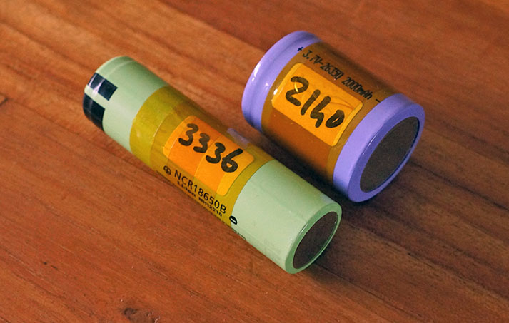

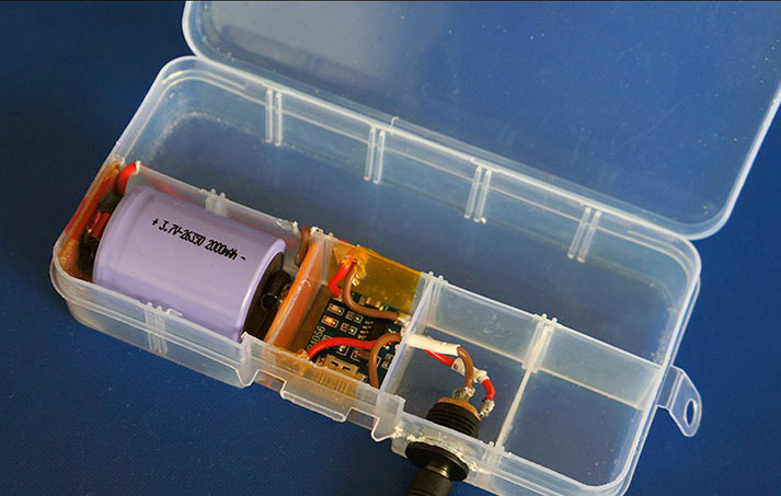

I'm not pleased with the size of the 18650 battery (2 batteries can be added + a connector for a 3rd.). I'm seriously thinking about walking back to a small 1200 mAh lipo.
#80
consider :
RAK811
26350 2000 mAh Li-ion
