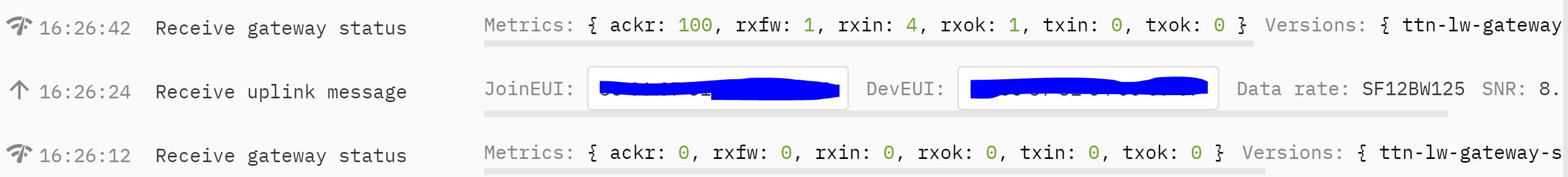

My gateway seems to be picking it up, but on the application page there is nothing. The same message still repeats.
 ![Capture](https://www.thethingsnetwork.org/forum/uploads/default/original/3X/2/0/20755745d3341dc94a58b8b0c4596486439cf0e1.png)
I also noticed the spreading factor is 12 when it should be 9.

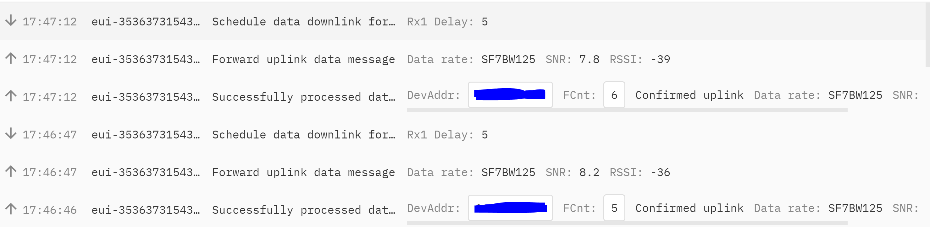

Every time I try to send a message with this code, it doesn’t work. In the TTN application console, I can see a confirmed uplink, but not the message.
 ![image](https://www.thethingsnetwork.org/forum/uploads/default/original/3X/b/0/b059e2e6aad7a0395c7a5f9b06652ddc20dae688.png)
The spreading factor also seems to change from 12 to 7 constantly.

Several issues wth what you say - firstly please avoid using confirmed uplinks - the TTN FUP limits you to 10 downlinks per day inc e.g. join accepts etc. and in reality you should think in terms of max 1 per week or even 1 per month! (Ideally once in its life - when 1st joining and retaining state thereafter!). The GW is deaf to uplinks each time you send a downlink (as happens with a confirm ack). 2nd It looks like you are very close wrt node to GW distance - move atleast 5m, pref 10m away and ideally with an absorber such as a wall inbetween - RSSI at -36 - -39dbm mean most likely you are shouting in the ears of both devices and signals are apt to be corrupted and mishandled. Aim for RSSI \<\<-50dbm, pref \<-65dbm. Moving from SF12 to SF7 is not suprising in such circumstances (if ADR enabled device will quickly move to lower SF is starting higher) and the lower the SF the better wrt time on air (congestions) and battery life (RF energy consumption) and is A Good Thing™ 🙂 You also seem to be TXing too often (back off time between send attempts to stay within regs and DC limits if applicabe in your territory and within FUP for uplinks (max 30sec/day) and to give GW time to breathe and pass messages too and fro (Acks, MAC commands etc.)

Please do not post pictures when text can be copied & pasted over please. Please see [guidelines](https://www.thethingsnetwork.org/forum/t/how-do-i-format-my-forum-post-howto/8735)
Why do you think the DevAddr should be confidential?
> [@SEAN\_K](#):
Apart from the grievous error of sending text, if the message is received, it’s there somewhere, click the Forward uplink data message line and look for frm\_payload in the JSON on the right.
BTW, once every 20 seconds is 7.4x more than FUP at SF7 and 189.9x more at SF12.

I have found the frm\_payload, but it isnt decoded. Usually, it would show the hex payload in the stream. I can’t see this. I am using a payload formatter to decode the payload.

That is the pre-decryption payload - you need to:
> [@descartes](#):
> click the **Forward uplink data message** line
and not the "Successfully processed … " line.
What payload formatter are you using to decode the payload?
It may well show the hex payload if you turn off confirmed uplinks - I can’t remember, I can’t remember when I last looked at confirmed uplinks so I can’t remember how the console log changes when you do.
Your OTAA connect is OK, the one without the DevEUI uses the Murata module DevEUI which Arduino generate from the STM32L073Z serial number. Depending on which firmware depends on whether it comes with the official Arduino EUI prefix or is an officially unofficial generated one. Which is what the FirstConfiguration sketch is for. Or you can use a TTN generated one with the three parameters. @Jeff-UK was referring to the blitzing of the FUP with all those confirmed uplinks, not the connection method.
