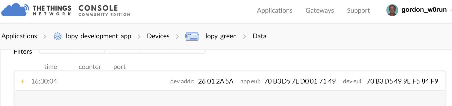

There must be something intermittent- it just started working:
 ![image](https://www.thethingsnetwork.org/forum/uploads/default/original/3X/a/3/a39a2234fed5162da0fd606f5ceacad61af4e5ff.png)
And I now see huge transmit signals from it on my analyzer. I happened when I moved it from one bench to another- I had left the node running it’s join script. I did nothing except power the gateway down, move it, and power it up again- so all the EUIs etc were correct. It had to be something physical.

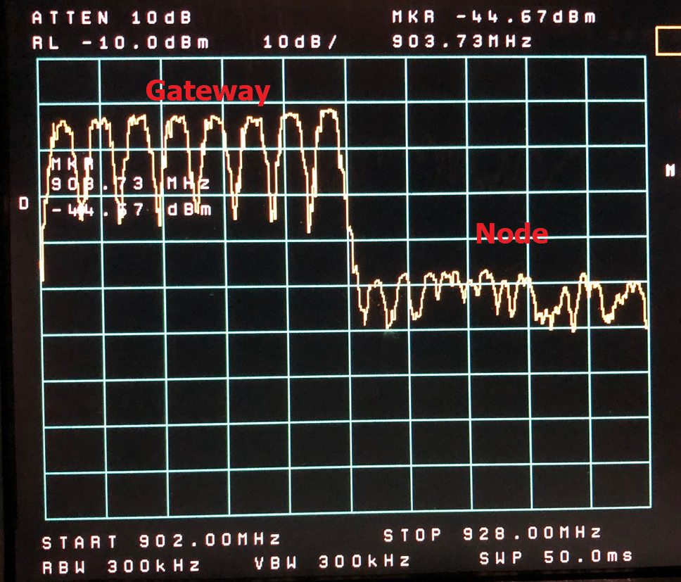

Just for completeness, this is the spectrum. It appears the node uses the upper half and the gateway the lower half of the band:

If you’re in the US, thats backwards. The node should be down around 904-905MHz and the gateway should be around 923-928Mhz. This is the channel layout for US915:
## US902-928
Used in USA, Canada and South America
Uplink:
1. **903.9** - SF7BW125 to SF10BW125
2. **904.1** - SF7BW125 to SF10BW125
3. **904.3** - SF7BW125 to SF10BW125
4. **904.5** - SF7BW125 to SF10BW125
5. **904.7** - SF7BW125 to SF10BW125
6. **904.9** - SF7BW125 to SF10BW125

Ah, were node and gateway very close to one another earlier? That could cause problems too (including receiving a single Join Request multiple times on different frequencies, where TTN might choose the wrong one for the Join Accept); keeping them a few meters apart is usually recommended.
<div class="post-metadata">
**Author:** ![gordon\_w0run](https://www.thethingsnetwork.org/forum/user_avatar/www.thethingsnetwork.org/gordon_w0run/32/45667_2.png) [@gordon\_w0run](https://www.thethingsnetwork.org/forum/u/gordon_w0run)\
**Post date:** [January 30, 2019, 2:46pm UTC](https://www.thethingsnetwork.org/forum/t/otaa-woes-ttn-gateway-and-lopy/21929/19 "2019-01-30T14:46:41Z")
</div>
@afremont: Yes, I was just coming to that conclusion too. I wrongly assumed the higher level one was from the gateway! In fact I believe the power output from the gateway is very low. As you can see from the spectrum, some 40 dB or so less than the node. It should be at least 20dB more, I think. I think a lot (most?) of my problems over the last year have been due to the poor RF performance of the gateway.
I don’t see anything on the forum or the web more generally about getting the gateway repaired. I also could not find a source for the Microchip RF module that is in there, I assume it is the problem. So I guess if I want to continue on with this, I will have to put out the $$ for another gateway. The question is whether to risk another TTN gateway or go for a more expensive one… It seems Element 14 has the TTN gateway in stock.
I wonder if there is a simple procedure somewhere for verifying that the RF performance of a gateway is what it should be? Something like set up the gateway and node with standard whip antennas vertical, separate them by 100m with nothing in between them, and try to connect. Can the node report signal strength? Otherwise you need a spectrum analyzer with another antenna. Knowing the distances, one can calculate what the signal strengths should be. Is there a way to change the “Fair use policy” for commissioning/test purposes? Especially in an area with little activity.
