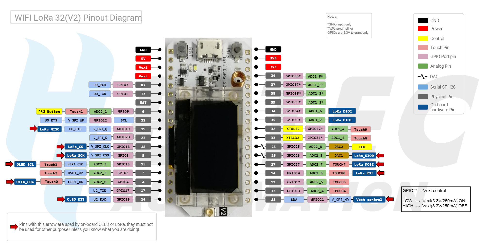

GPIO27 is wired to LoRa MOSI
GPIO19 is wired to LoRa MISO
To prevent issues you should not use these GPIO’s to trigger external wakeup interrupts from a PIR.
Not relevant for your issue, but note that Heltec Wifi LoRa 32 V2 has I2C related configuration issues.

Thanks blueJedi. You are right i will change the GPIO port. As declared in the layout only 2,12,13 are free to use for digital in.
