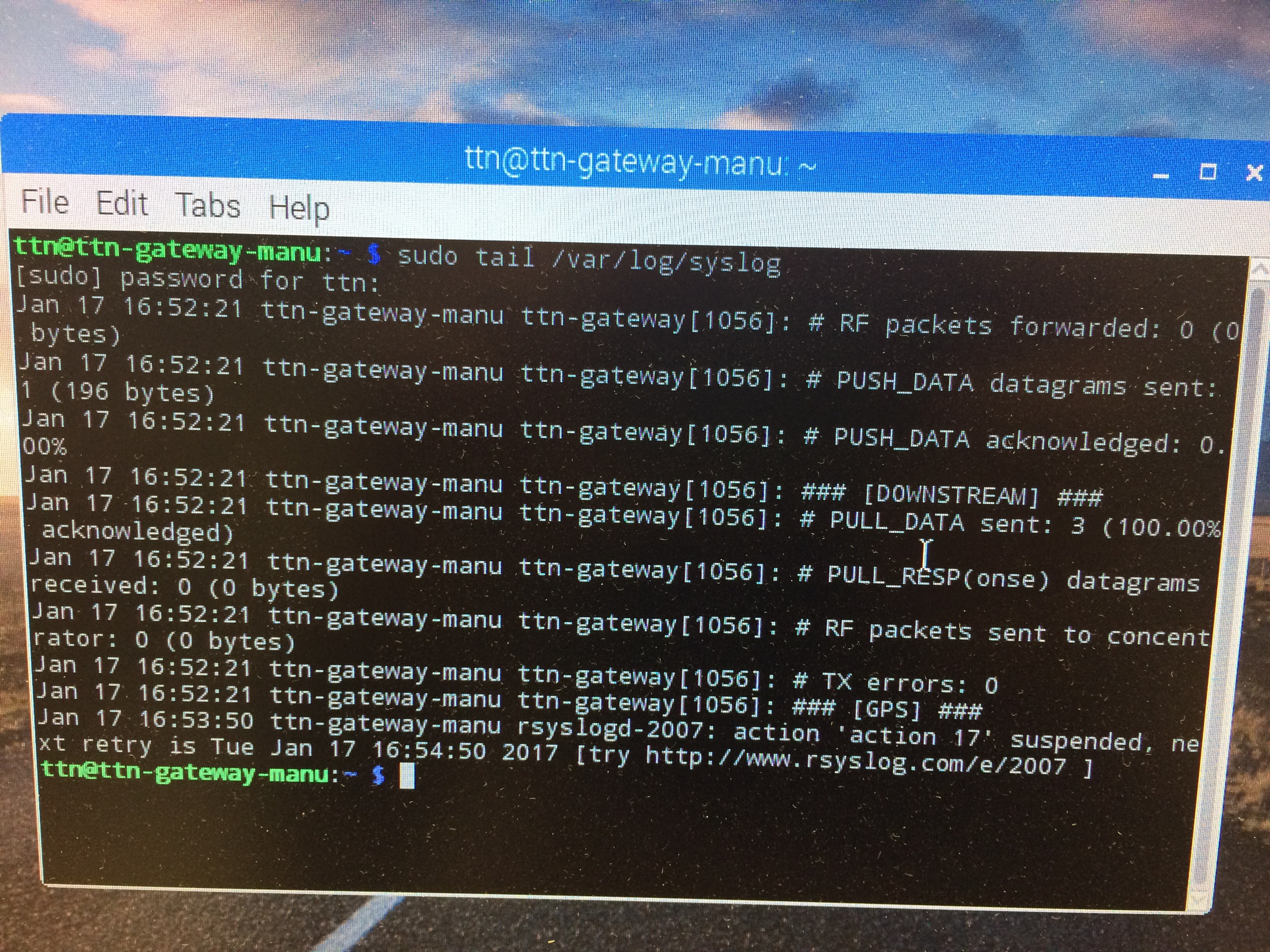

I see no log file there. There ist just this output
–Logs begin at Tue 2017-01-17 16:39:27 CET, end at Tue2017-01-17 16:47:24 CET –
Where can I check the packet forwarder? I did exactly the instruction of this link
> **[ttn-zh/ic880a-gateway](https://github.com/ttn-zh/ic880a-gateway/wiki)**
> Reference setup for iC880a gateways running The Things Network - ttn-zh/ic880a-gateway
My Gateway is online but I do not receive any message. When I use this command I get the following
 ![](https://www.thethingsnetwork.org/forum/uploads/default/original/2X/8/8f89ae8b95c85f5e1a5e91d215fa0bebc527f53e.jpg)
Furthermore my Gateway receives no messages but is active and connected.
Any idea?
Thanks
Manuel

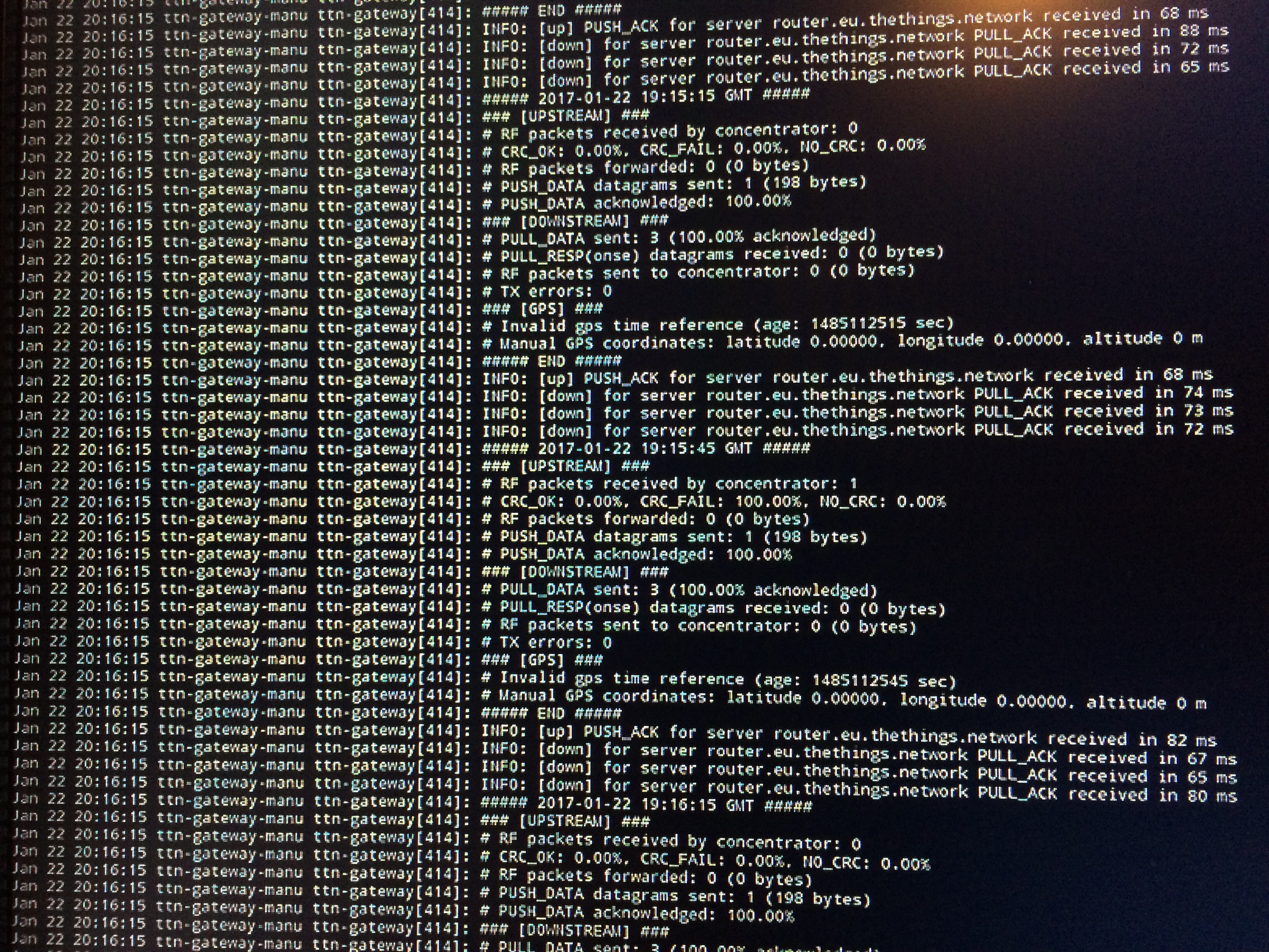

sorry I checked everything today again and I receive packets. These packets are 100% CRC\_FAIL.
But even when my node is powered off I get the CRC\_FAIL 100% and the information that my concentrator received 1 or 2 packets.
There is a screenshot:
 ![](https://www.thethingsnetwork.org/forum/uploads/default/original/2X/8/8df5ee5c36ee50f1f1e92916e85cb32e013e8ca7.jpg)
What means the CRC\_Fail? How can I slolve it?
Thanks
Manuel

> [@Omarama](#):
See [https://www.thethingsnetwork.org/forum/t/ic880a-rpi-2-a-lot-of-crc-fail/1694](https://www.thethingsnetwork.org/forum/t/ic880a-rpi-2-a-lot-of-crc-fail/1694)
<div class="post-metadata">
**Author:** ![kersing](https://www.thethingsnetwork.org/forum/user_avatar/www.thethingsnetwork.org/kersing/32/44777_2.png) [@kersing](https://www.thethingsnetwork.org/forum/u/kersing)\
**Post date:** [January 23, 2017, 4:12pm UTC](https://www.thethingsnetwork.org/forum/t/raspberry-pi-3-ic880a/4870/10 "2017-01-23T16:12:31Z")
</div>
> [@Omarama](#):
First the good news, your gateway works as expected. The packets with CRC errors may be LoRaWAN packets from another node that can not be received correctly or just noise which resembles a packet. Nothing to worry about and nothing to be done.
