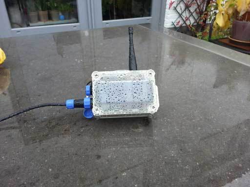

This PCB and enclosure will be used.
Live update on Thingspeak -> https://thingspeak.com/channels/113020
(first 3 graphs) Currently testing with standard alkaline, just outside for 1 hour least.

@veen10
Nice enclosure, where do you get these nice waterproof connector ?
#28
You can get them here:
https://www.conrad.nl/nl/brandlist/weipu.html?category=%1FElektromechanica%1FConnectoren
For prototyping, they are pretty good. For the real thing i would use better connectors with full metal housing like Binder or Amphenol.
