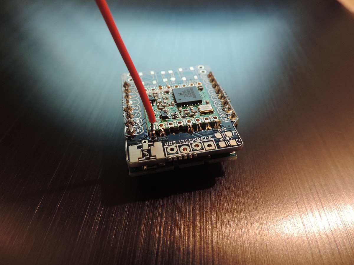

I made a gateway yesterday based on the Wemos D1 mini (ESP8266) and the small shield board of @Charles (they can be ordered from pcbs.io for $5.30 per 4 including shipping).
You have to change the ESP-sc-gway20.ino file so that dio0 is referring to D8/GPIO15 and solder a small wire at the backside of the shield board to make that physical connection. dio1 and dio2 are not used. Done…

Just curious you soldered a wire instead of D2, right ?
Just did not have a small diode available so indeed I soldered a wire. Seems to be working without problem. Maybe for next gateways I will use D2.
Just curious also: Does the board work as a LMIC node without dio1 connected to a separate pin?
if you just need DIO0 a wire is fine, but as soon as you need DIO0 and DIO1 (LMIC for example) you need to
  • Choice 1 : solder D2 and D3, so yes it will works with LMIC with only one GPIO
  • Choice 2 : direct 2 GPIO connection, no diode,
    • wire from DIO0 to GPIO15 (as you did)
    • and for example DIO1 to GPIO4
    • and depends on you needs (FSK or not) for example DIO2 to GPIO5
And of course In both cases, you need to change pin definition in your LMIC sketch
Very elegant solution in software! I use my own LMIC version also so I’ll have to build a separate version too if I use these boards for sensor nodes.

I build your version 1.0 PCB Gateway but it does not seem the function well.
After trying several settings i am able to receive packets but when i look at the gateway status it shows:
5CCF7FFFFF81C496 Uplink:N/A Downlink: active Last Seen: now

The ESP-sc-gway20.ino file RFM-ESP settings looks like this >
// SX1276 - ESP8266 connections
int ssPin = 16; // GPIO15, D8, 15
int dio0 = 15; // GPIO5, D1, 5
int dio1 = 0; // GPIO4, D2, 4
int dio2 = 0; // GPIO3, !! NOT CONNECTED IN THIS VERSION, 3
int RST = 0; // GPIO16, D0, not connected, 0
DIO0 seems te be already connected with GPIO15 on the PCB.
So, the only thing I have to do is change the .ino file and solder a wire DIO1 - GPIO4? Right?

To be honest I didn’t tested well as SC Lora GW so I can’t really tell you, where is the source code you try ?
Anyway, you are correct, on V1.0 board, only DIO0 is connected to GPIO15
So you can connect DIO1 to GPIO4 for example so code should be like that (better to use NOT_A_PIN or 0xFF instead of 0 because 0 is GPIO0)

In principle even dio1 does not need to be connected, only dio0 for the code you are using.
Can you explain the issue you have? From what the webserver outputs, your 1-ch gateway seems to be working fine. The forwarded field is for downlink messages from server to node, and that is normally 0 for sensor traffic.
