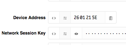

> According to [the documentation](https://www.thethingsnetwork.org/docs/lorawan/address-space.html#device-address-assignment) your `0x26012EBC` DevAddr seems to indicate it is still being assigned an address for the EU-region:
Thank you for this element. The device has been registered on EU868 but now I don’t see it on the EU868 Gateway traffic and the join accept is coming from the US915 gateway.
The gateway is configured like this:
 ![47](https://www.thethingsnetwork.org/forum/uploads/default/original/3X/7/b/7b4c07c25bae188e16fa9f6f296786fe7a80e702.png)
The gateway itself is connected on:
“server\_address”: “router.us.thethings.network”,
In the device itself I did not saw any setting related to location in the console. The device is setup (by TTN) to the corresponding address by I do not see how to clear it:
 ![25](https://www.thethingsnetwork.org/forum/uploads/default/original/3X/b/3/b3faeab4b7c8783c7d8a599aa5c35b974c99a2f6.png)
If it comes from the device adresse How do we manage device moving from a zone to another zone properly ?

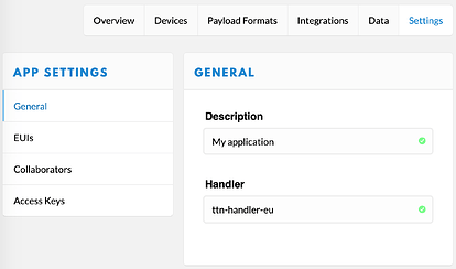

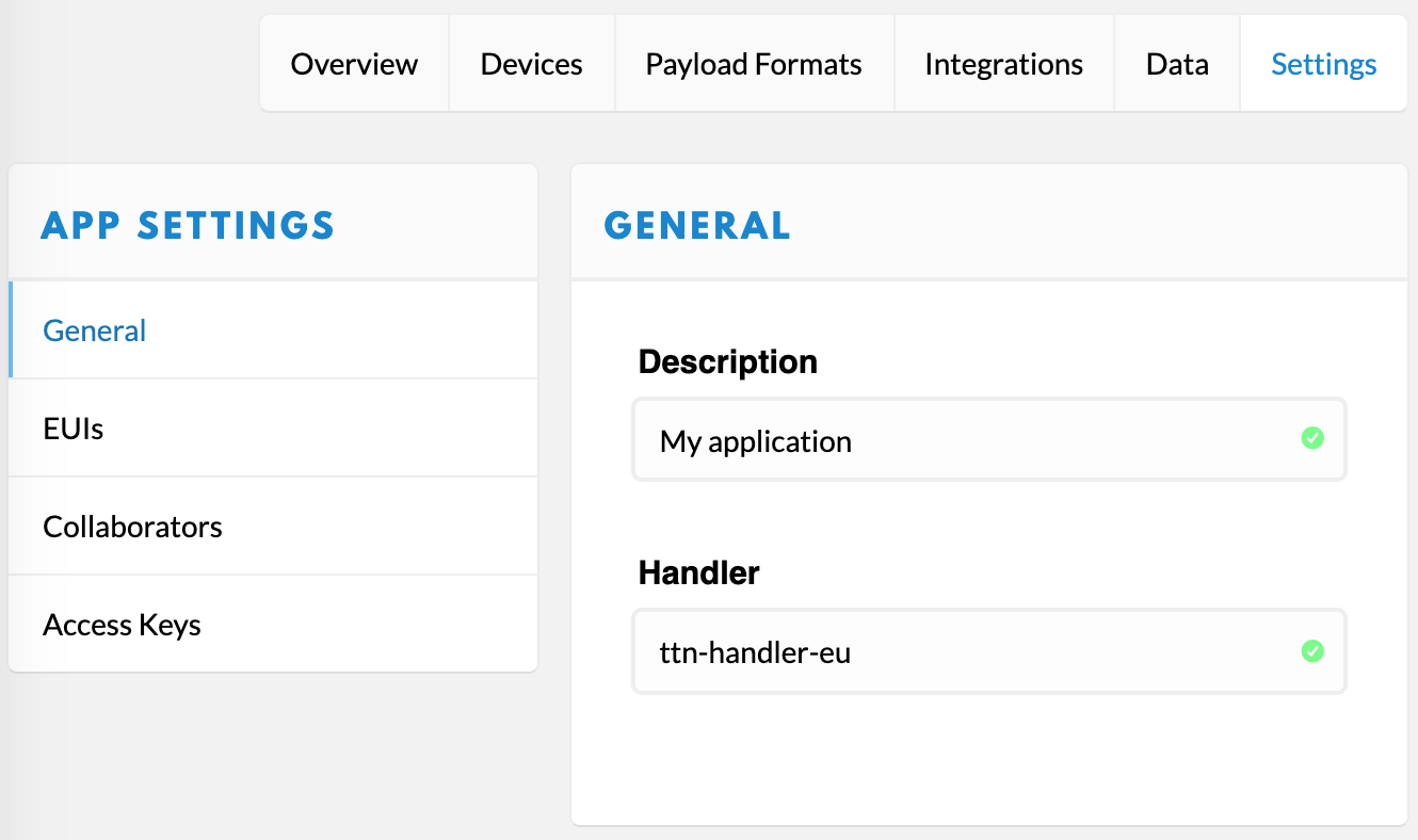

I was wrong about the devices; it’s the applications that have a setting for the handler, while in TTN Console devices should then be registered to a single application:
 ![TTN Console](https://www.thethingsnetwork.org/forum/uploads/default/original/3X/f/3/f3d1daeba39b7a2014bcdbecbb30c1d65924d085.png)
> [@disk91](#):
That has indeed not been implemented. Even within the single world-wide TTN community network, I’d assume this needs some roaming just like when it would be different networks, but as far as I know, roaming has not been specified yet, let alone implemented.
> [@disk91](#):
You cannot clear the DevAddr; a new OTAA Join will get you a new DevAddr.
I don’t know if _changing_ the handler for an application is properly supported. _Maybe_ deleting and re-creating is a better option.

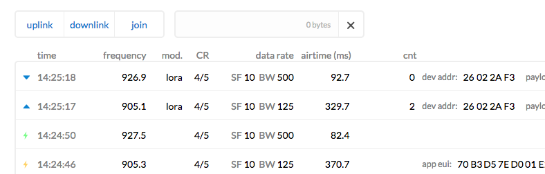

**Author:** ![disk91](https://www.thethingsnetwork.org/forum/user_avatar/www.thethingsnetwork.org/disk91/32/35863_2.png) [@disk91](https://www.thethingsnetwork.org/forum/u/disk91)\
**Post date:** [June 22, 2019, 12:29pm UTC](https://www.thethingsnetwork.org/forum/t/strange-behavior-on-us915/27301/8 "2019-06-22T12:29:43Z")
</div>
Good news it’s working better
 ![07](https://www.thethingsnetwork.org/forum/uploads/default/original/3X/6/c/6cf27815b37debf9a05a746a1620588b7c316f9f.png)
Now I have a downlink response.
and my sensors is working normally.
Thank you for the help !

> [@arjanvanb](#):
> For future reference: did you indeed create a new one, and did see which handler the previous one was using? And has there always been just a single application (at least: one that knew this device)?
I’ve created a new one on ttn-handler-us-west the original on was on ttn-handler-eu. The application was created specifically for this device. The device connect for the first time to this application from US915. The gateway use [router.us](http://router.us)
Previously, the application was on ttn-handler-eu, the gateway configured on US915 frequency. At first the gateway were connected to router.EU. In this configuration the device has communicated for the first time. Then the gateway was connected to [router.US](http://router.US).
