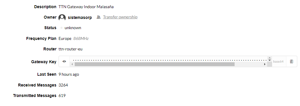

Some knowledge about my TTIG I wanted to share.
Gateway status is presented in console (When console operates, but I am not going in to that on this topic) but information derived from behaviour is different from what we know with UDP and protobuf type connected gateways.
With UDP and protobuf connected gateways everytime data is received from the gateway the last seen time is updated. The data that triggers the last seen time can be uplink data packets or status or link-ckeck-data. Using TTNCTL you get the same time as form consol at which the gateway is seen.
In the case of TTIG I observed a different behaviour. Here only uplink packets change the last seen time in console. Any other data will not update the last seen time. TTNCTL is no presenting an up to date last seen time.
As a result of this, a fully operational TTIG that has not received any uplink packet since powering on can have a last seen time in console of hours or many days ago!.
I think this is information you might want to know.
Correction: TTNCTL is not updated by any link activity!
