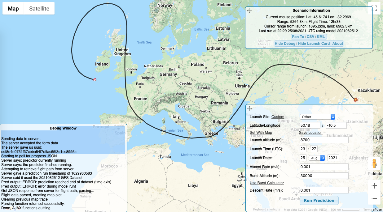

If it remains floating it will circle back over the UK at some point, down France and across to see Borat, the prediction is a bit of a hack as you can see from the debug log.
Screenshot 2021-08-25 at 23.33.05
