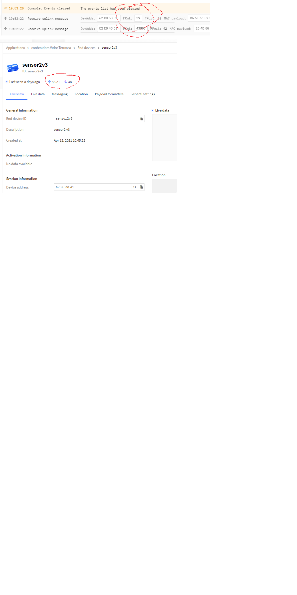

Hello,
Thank you, but the framecounter that I reset from the device, is the one that actually sends and receives for the gateway livedata FCnt: 1. How can I reset these framecounters (uplink frame count 3921, downlink frame count 38)?
I try to upload a picture where it can be seen that the gateway catch a message from the 62 C0 58 31 device, with its framecount 29, but in the application screenshot, sensor2v3 is last seen 8 days ago, and keeps the frame counts.

Please search the forum for the correct way to reset frame counters for a node in V3. You might need to use the command line tool to reset the ‘session’.

Rigth,
I check the Enabled in the Resets Frame Counters: Advanced Settings:Network layer: General Settings: End devices.
Afterwards, I activate the device, and effectively sends a new message, and it could be seen in the application Live Data.
I uncheck the Enabled again, and one other activation is also received in the application Live Data.
It seems to work fine, again.
Thank you very much.

> [@kersing](#):
> @descartes You are probably more experienced in reset ABP counters. Any hints?
Ha, I only use ABP for firmware radio tests and only when I’m testing firmware communications states, I’ve got the radio off the rest of the time as that bit is mostly a given.
`ttn-lw-cli end-devices reset [application-id] [device-id] --mac-settings.resets-f-cnt true`
