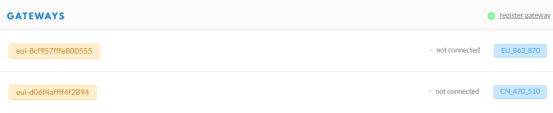

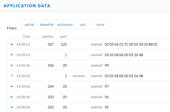

Why does the gateway show that it is not connected, but the application and terminal devices can still upload and download data?
This is a phenomenon displayed by the gateway, showing that it is not connected.

This is a phenomenon displayed by the application, and the data is normally uploaded and delivered.

It ~~is~~ was a known issue; see [https://status.thethings.network/](https://status.thethings.network/) (meanwhile [resolved](https://status.thethings.network/incidents/jcpby2d14qt8)).
Asides: why does the screenshot show both EU\_863\_870 and CN\_470\_510? (Maybe fine for your region; I don’t know, but it looks weird.) And if you’re _always_ sending data this often then beware of [the LoRaWAN limitations](https://www.thethingsnetwork.org/forum/t/limitations-data-rate-packet-size-30-seconds-uplink-and-10-messages-downlink-per-day-fair-access-policy-guidelines/1300).

Because I run two gateways, one is 470MHz and the other is 868MHz.
