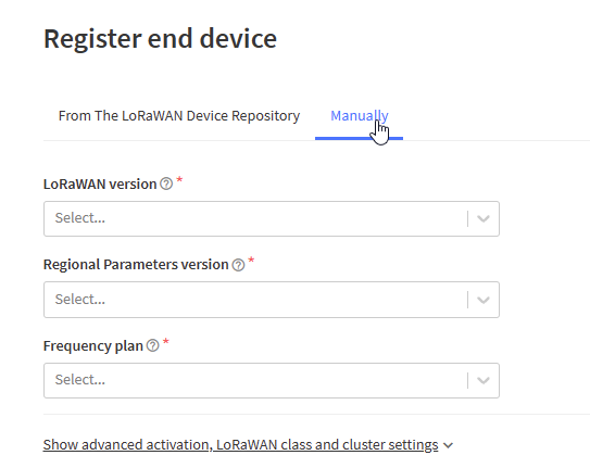

I have also have a couple of feather m0 lora, does any body know how to configure “add the device” in an application. it does not appear as one of the supported devices and I have no idea of how to add the device manually.
Maybe you have been able to configure it in TTN Console V3, and your knowledge would be greatly appreciated.
Regrads, Victor.
It’s just generic device so the docs & form aren’t that special, you could configure any device with them, as we did for devices in the repository before it existed.
So use the LoRaWAn version appropriate to the firmware, frequencies appropriate to your region, get the console to create the EUI’s and AppKey and put that in to the firmware.

I’ve been using the MCCI Catenna LoRaWAN library Version 3.3.0, this by default will be LoRa MAC Version 1.0.3 for library version 3.3.0, so in TTNv3, select “manual” then select MAC version 1.0.3 and then the second PHY will be only one available and auto-selected - which narrows it down, only do this if you are using the same library as I have been.
Then select country/frequency plan that suits where the device will be deployed - this matches exactly what you programmed the node too, e.g. MCCI you have to select frequency plan in lmic_project_config.h from the library before compiling (best to edit config file, save and then re-open the project) then in the code state for US915 and AU915 for example the subband 2 (at least this is still manual process in MCCI 3.3.0 library because of the vastness of AU915 etc) to select this use the line " LMIC_selectSubBand(1); " in the void setup section, where (1) = Subband 2, (0) = Subband 1, if your frequency plan doesn’t need sub-band control (e.g AS923) then comment out the subband section in void setup.

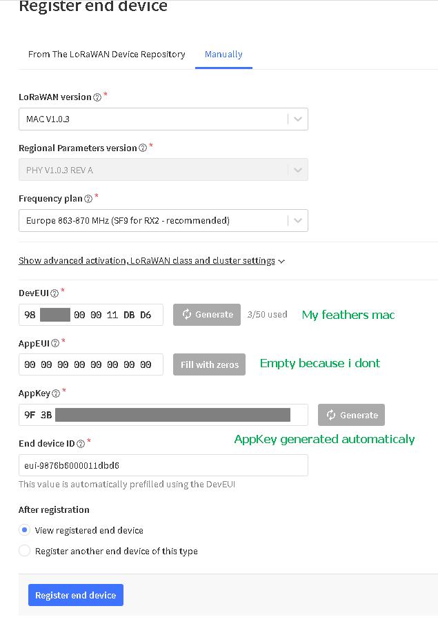

Hi thanks for your help, I have just registered the feather as a manual device as show in the image.
Now i suppose in the arduino code i have to fill in the APPEUI, DEVEUI, APPKEY in little indian code.
Also I have eddited the config.h file to 868 EU.
I will give it a try in mo.

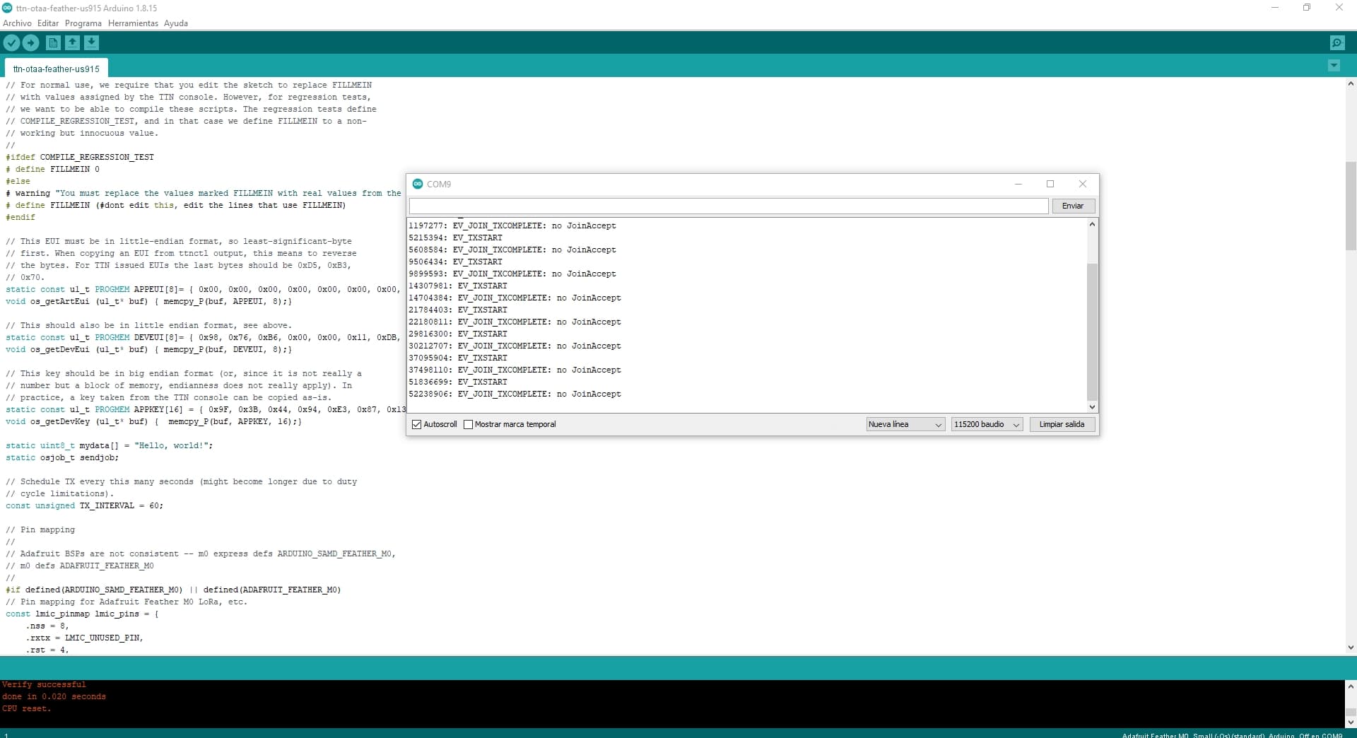

But im still getting in the ardunio serial 115200 (bauds): as shown in the following image.
Starting
12270947: EV_JOINING
12271537: EV_TXSTART
12673403: EV_JOIN_TXCOMPLETE: no JoinAccept
screen capture
Im stuck now because it should work. Any idea what i should do next?

Apart from mismatching networks, I have noticed a possible error in your code, I think you need to switch the DevEUI to LSB before copying from TTN and/or entering this into the code.

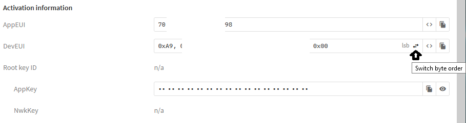

You can do this manually after you had created it, this is done nicely by pressing the “toggle array” button, then press the dual arrow area OR “MSB” spot when expanding the DevEUI in the activation information section for the node. Once pressed it will re-order to LSB, then copy and override in your code to have it the correct way around.
I worked this out from the screen grab of the keys in IDE you have shown, noted you have copied the DevEUI direct from TTN OR entered it as per from Adafruit in MSB "0x98, 0x76 etc… first.
This has to be reversed to have 0xD6, 0xDB first left to right.
This condition that the library needs for LSB also affects the AppEUI - but being all 0x00 has masked the issue there at least - but in future any other AppEUI (such as IEEE issued AppEUI) other than all 0x00 have to be entered in the code as LSB just like the DevEUI.
Note as indicated in the IDE code, AppKey is expected to be in MSB, so is copied direct from TTN without having to switch it from MSB to LSB.
