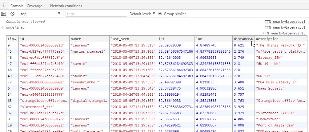

To see the TTN Gateways in your hood, run this Chrome Snippet in the Dev Console:
console.clear();
nearbyGateways( 52.4 , 4.87 );  // latitude, longitude

It will call the (unofficial) TTN locations endpoint, returning the nearby gateways
the script calculates the distance (KMs) and prints a table in the console, with click/sortable columns:
