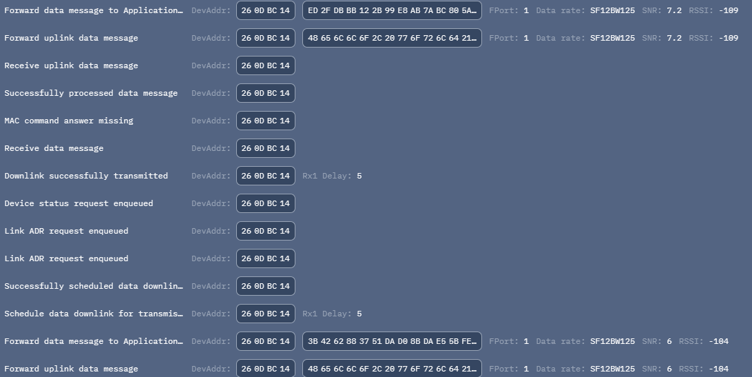

Server is responding as mentioned by @descartes. I tried changing the SF to 7, 8 etc. It is working. The server is no more asking SF12 (DR0). (Using CLI as mentioned by @descartes)
This would have been some setup mistake from my side. Along with the mistake my node was not able to receive message from server. So server kept asking status of node along with SF7 DR5 request this time as there was no reply to status query. This is normal procedure when a ABP node joins.
So since the server was not getting the status message back, it kept asking for status messages. (tried for atleast 2000 messages, it doesn’t stop)
So in short:
  1. DR0 request from server was solved using the solution provided by @descartes
  2. I kept receiving status request from server until the node replied with status in mac field.

So there could be one more solution possible in the scenario, if somehow the gateway is not able to make it upto the node and only the node is able to communicate, which is ok for a mapper node, if there was an option to disable status request then it would have been great, to avoid unnecessary TX from gateway. (tried 0 fields in status in console to disable, didn’t work possibly because its a usual join procedure of ABP, minimum one status message back to gateway)
