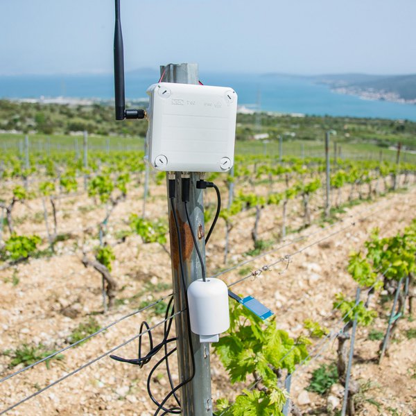

Very nice project!!! Thanks for sharing.
One question please: Did create a special “case” for the BME280 to protect it? It is not fully obvious from the pictures but seems it is mounted at the bottom of your box in a kind of pipe?
I bought the BME280 as well and want to test it but I do not want to expose it directly to wind/sun and above all rain. I saw that some people are very creative and eg printed a case (eg https://www.thingiverse.com/thing:1523429), therefore would be very interested to learn about your solution.
I made some temporary solution so the sensor is not exposed. But I’m working on finding new solution. Just send some model to 3D printing because I don’t have one yet. Sensor cover should make sun and rain protection, and should be airily to get accurate measurements. Search on Thingiverse “Stevenson” or “stevenson screen”. There are few different dessigns, but noone is ideal.
