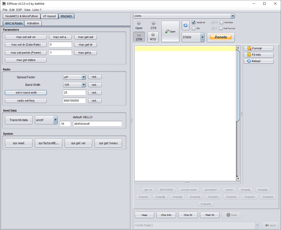

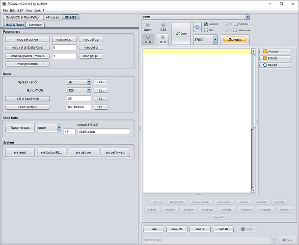

maybe have a look at this application so you can easyier set the radio module over UART

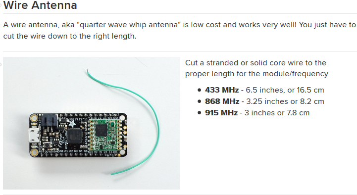

So what Adafruit recommends below is wrong? Would it be advisable to go for 8.6 cm length antenna instead of 8.2 cm?
No they are right. You have to apply the velocity factor of arround .95.
86mm multiplied with 0.95 gives 82mm.
