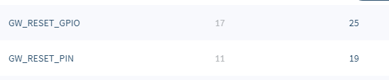

@Jeff-UK, definitely! The only objection to this fact is, RAK831 sometimes work with wrong settings also as you can see here (my first RAK831):

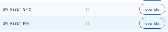

But my second RAK831 starts only with right settings:
Anyway, thanks to @gy4nt and @Jeff-UK - youβve pointed me into right direction!
