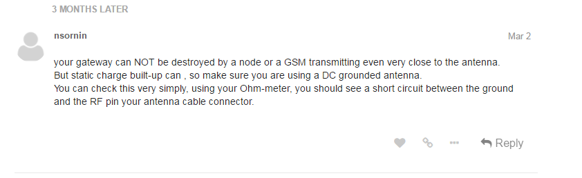

It is clear that Gateway will not be affected by end node and GSM. But i would like to understand the affect of gateways when they are nearby 2m.
