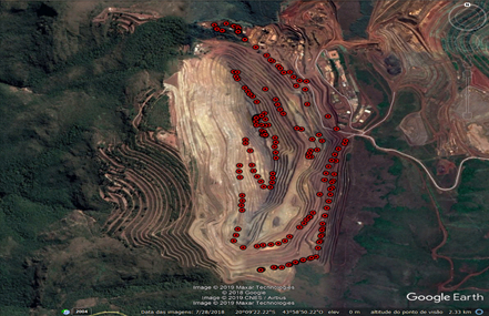

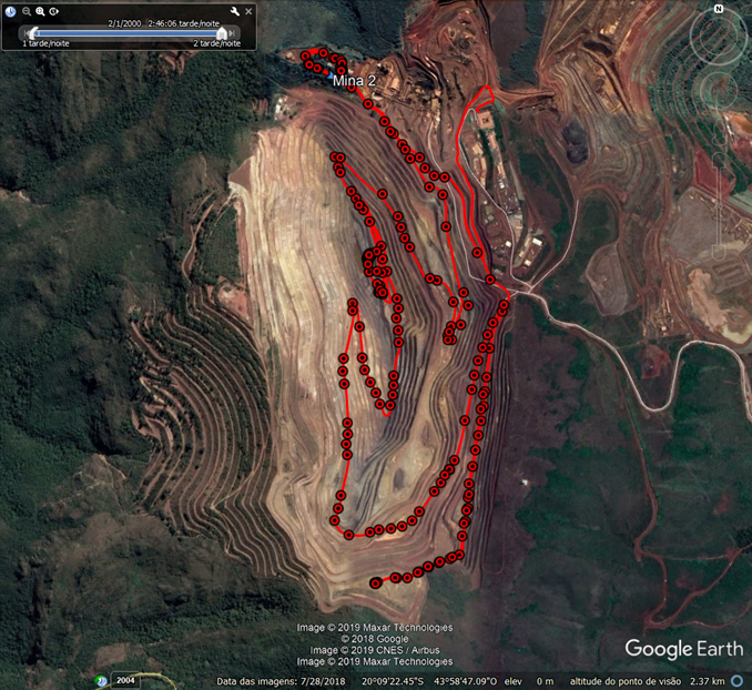

I did some tests and we had quite of good results. The line in red represents a commercial GPS for vehicles and the “circular points” are the coordinates from my lora device.
The climatic conditions were good in the day of the test Temperature min 24 ºC , max 32 ºC, the relative humidity was 22%-57%.
