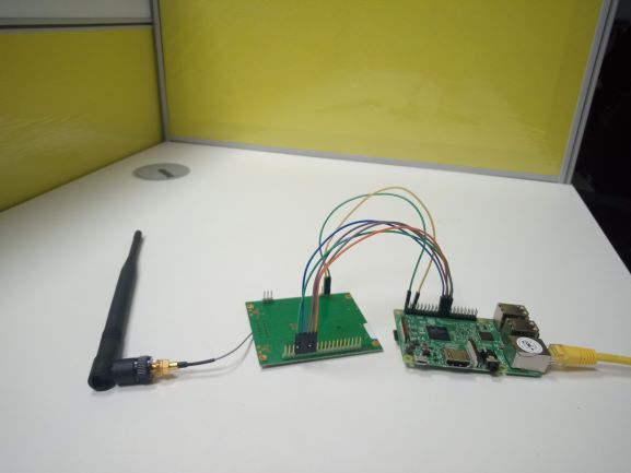

Do you mean to say a gateway can be configured to any frequency? I have my iC880A-Pi3 gateway configured and connected to TTN (picture attached). Can I just select any frequency plan given in the drop down menu, and start using it? What other changes should I make? Gateway

Hi people, finally I was able to set-up my gateway here in india and exchange few data packets with TTN and also get my gateway shown on ttnmapper. It turns out to be lot simple and straightforward with a little bit of guidance. I have summed up my experience in the below video, hope it is useful and answers all your questions
Setting up LoRaWAN Gateway in India using TTN and RG186
Feel free to reach me if you face any problems
