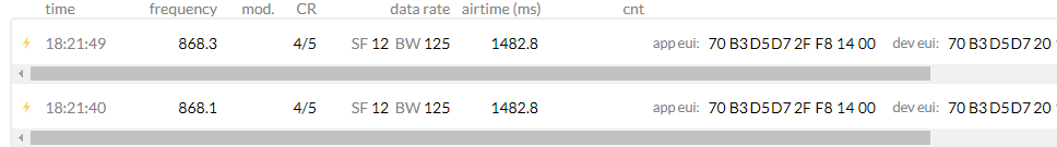

Hey arjanvanb,
where did your friend use it earlier?
My friend used it on a different network server. So he never actually configured here on TTN and the other server it not anymore available
I remember him showing me that the data was coming in and he has been using it for couple of months before he deleted it on the other server and gave it to me to practice and get going with LoRa.
I have double/triple checked all the keys and also replicated it to TTN as they were provided by my friend and it still just shows me the Join request.

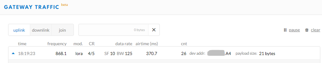

Luckily, my friend provided me with another device (temperature sensor) and he also gave me exactly the same type of information
So here, i did the same as before and made a new Application and registered a new device. But this case was different that the previous one, because now i could finally see the Sensor only and also receiving data from the Temperature sensor

It indeed seems that you were right @arjanvanb. The data that i got from my friend doesn’t match with the one on the sensor itself.
I need to do a bit more digging to see if I can find what keys are actually on the sensor itself.
