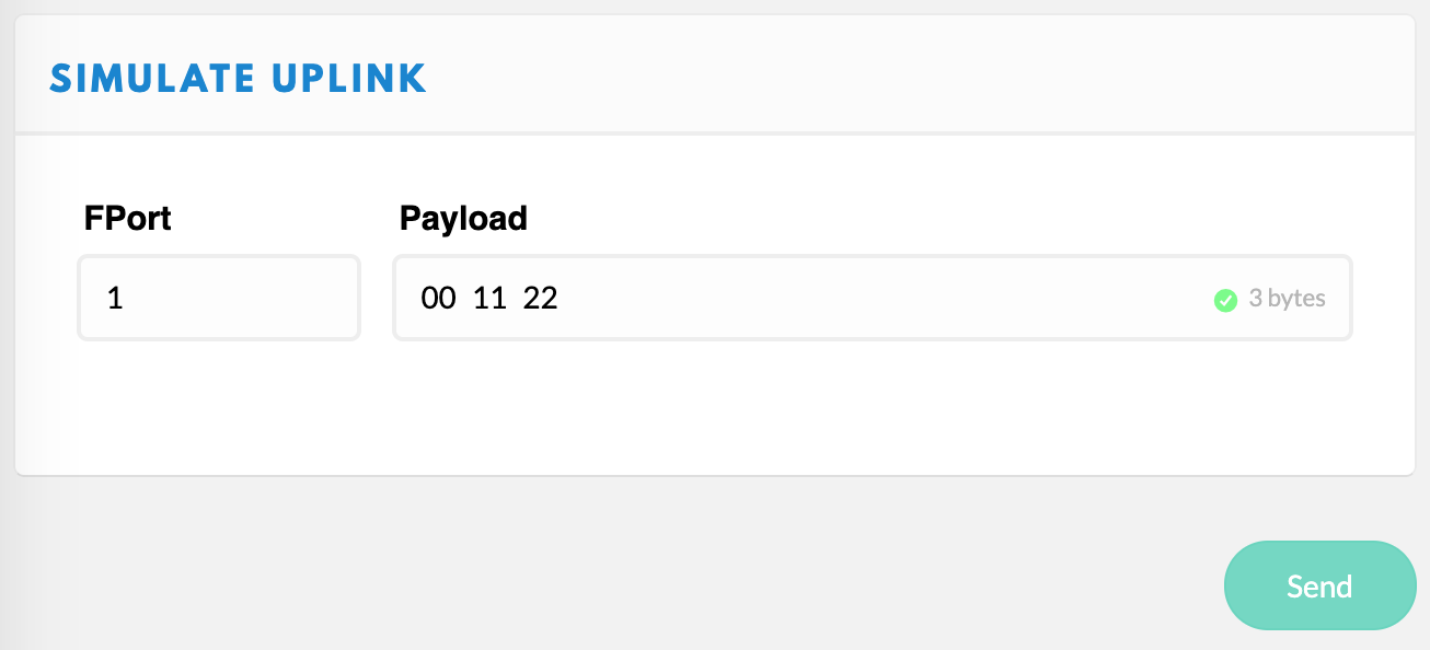

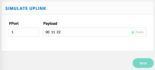

Also: TTN Console allows for simulating uplinks in the Device Overview page. This expects an non-encrypted application payload (which, in an encrypted version, would be part of a full LoRaWAN packet as sent by the device):
The same can be achieved with the ttnctl command-line interface.
