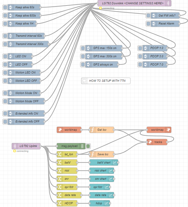

If anyone is interested in this Node-RED flow. You can use it to send settings to the LGT92 via TTN, and it displays the location and dashboard info from the LGT92.

I created an export of my flow. Copy and paste above JSON into the Import screen of Node-RED. MQTT client, Dashboard and Worldmap must be installed in Node-RED palette.

Setup after import into Node-RED:
  1. Go to the console of TTN.
  2. Find your applicationID and LGT92 DeviceID
  3. In application go to the tab ‘integrations’
  4. Under MQTT you can setup a username and password (=api key)
  5. Fill in the username, password, applicationID and deviceID in the MQTT node ‘LGT92 Downlink’

So, i’m quite new in lora and ttn and for a specific use case I started with the LGT-92. But the messages were far from complete. A couple of datapoints in the messages stayed 0. (pitch and roll data). So to understand better I had to check the payload formatter or check how the downlink works.
I never worked with the downlink and after spending hours in the documentation I couldnt get it working. Thanks to the workflow from @Gruijter, I was able to learn how downlink works (in 5 minutes!!) and set the extended info “ON” (downlink: sAA=). This solved the issue for me.
