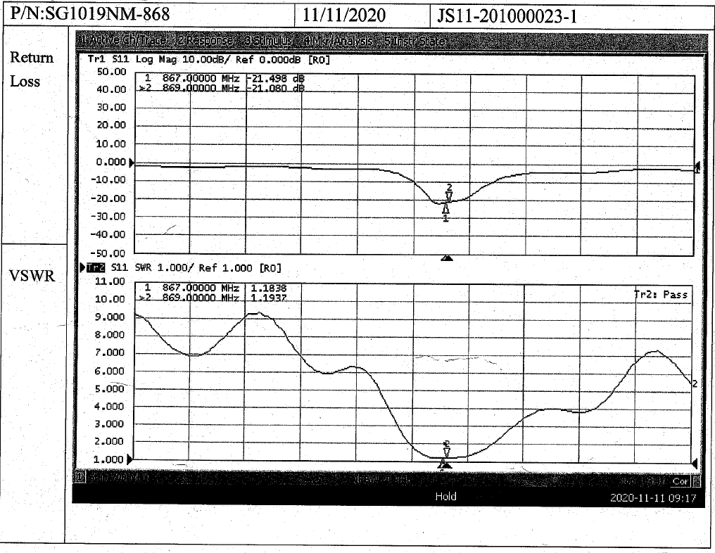

I asked to the manufacturer and he confirms it’s a 5dbi antenna with ½ wave design.
He sent me the measurements (not for the good frequency…)

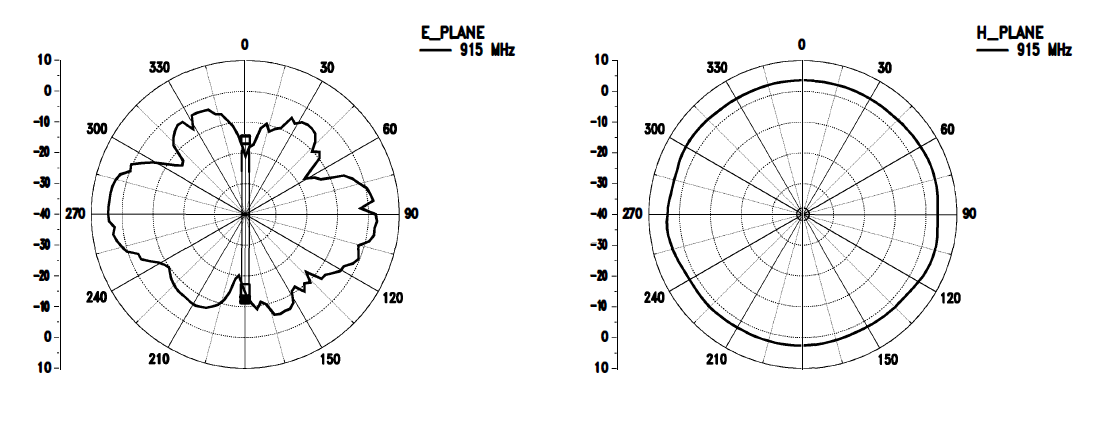

The VSWR looks good for 868 MHz. But VSWR and gain is not everything. Pay attention to the radiation diagram, it depends on the frequency you use. If you use an antenna outside its intended frequency-range it might happen that the antenna radiates “up into the sky”.
Well I received the radiation diagram from the manufacturer:
Not sure to understand everything but it looks good, not up into the sky like you said

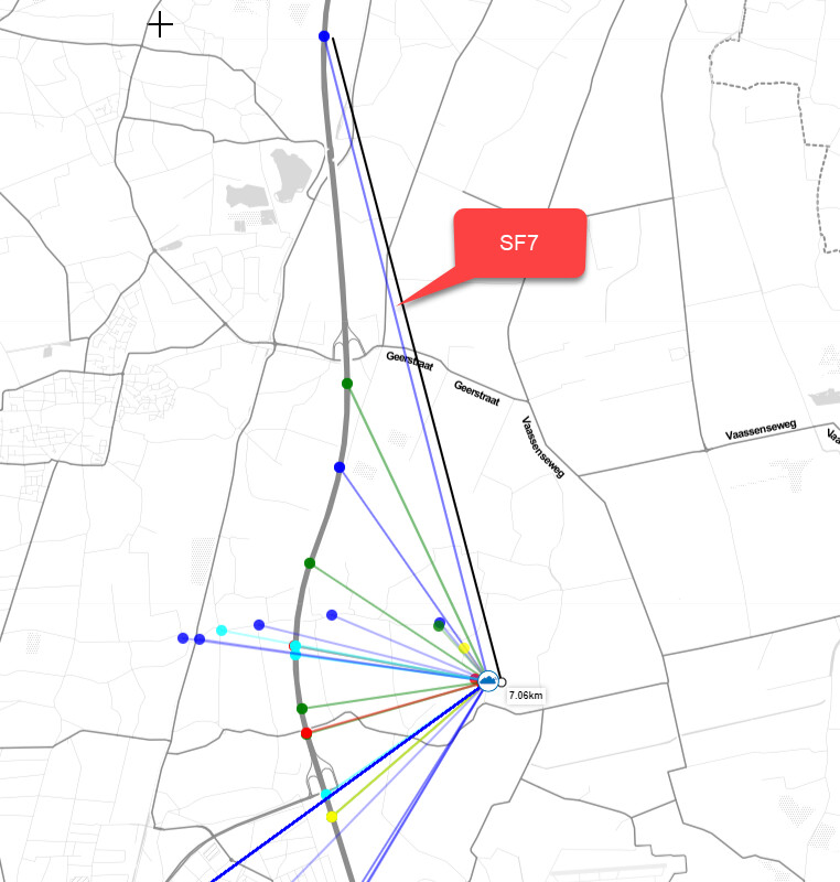

For the ones that are interessted:
Dragino LPS8 - with BLG-AN-040 mounted on 5 meters above ground.
Wow nice! are you in an urban area?
No it’s on the country side a lot of farmers around the gateway.
