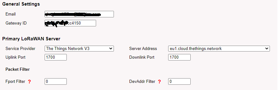

I keep seeing you refer to ‘LoRa’, and you mention a Dragino GW…just to be sure you mean LoRaWAN right? Your GW is a full LoRaWAN GW (Dragino LPS8, LG308, etc. not a Dragino SCPF/DCPF LoRa only device?) and you have device operating in LoRaWAN mode, right? Not LoRa only… LOng/poor messages not withstanding , as an Acsip based device atleast the meter can be/should be set up as LoRaWAN vs LoRa propretary.
Yes, sorry, my mistake. Dragino LG308, configured as seen in picture.
Great :+1:

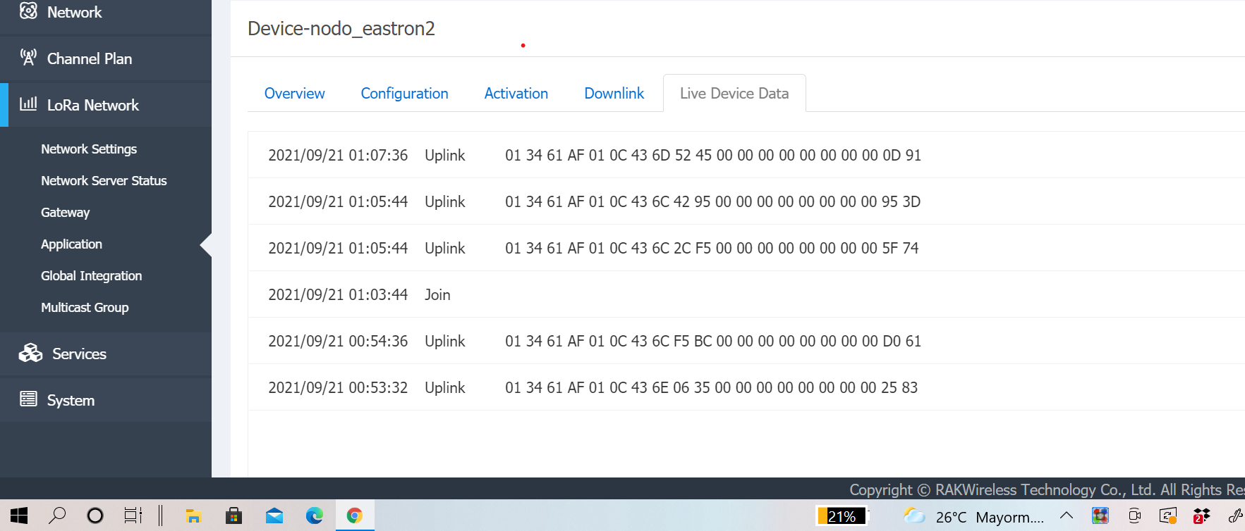

From what I see, my device only sends a line, so I need to activate this data with an ascending command in the counter, someone can contribute something.
I have a report every minute and always on the same lineCaptura de pantalla 2021-09-21 010847
