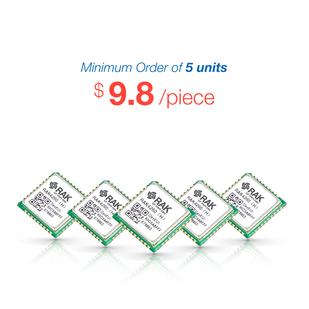

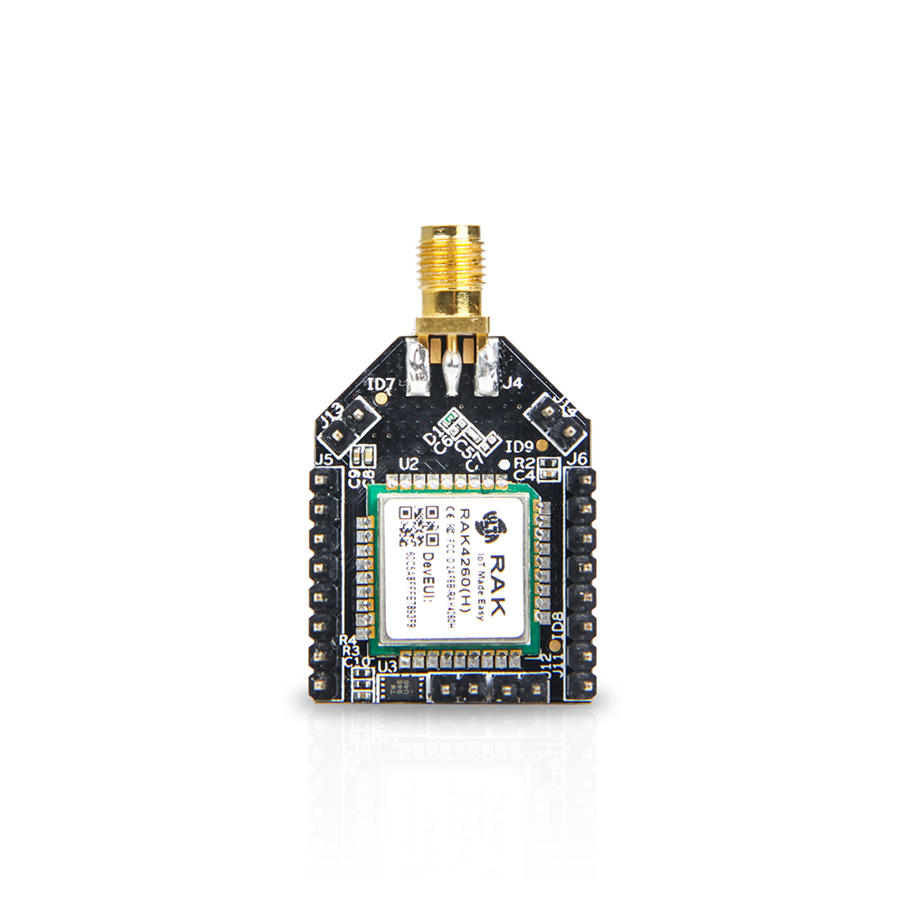

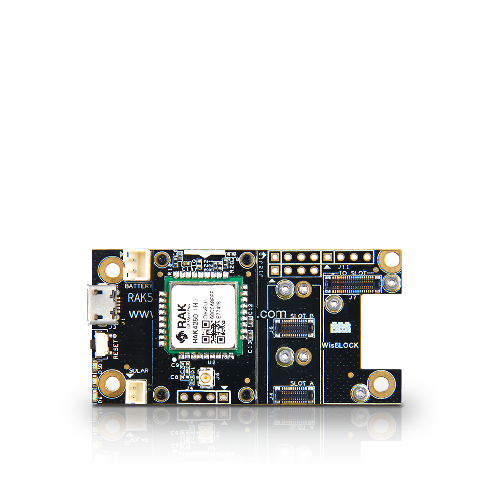

and when you are happy to go over to a module, you can get it pre-packaged from RAK as a dev board, a breakout board and a module:
There were certainly some hiccups with RAK’s first release but between staff, resellers & technical end-users it is working like the Microchip board.
This does not do AT commands, so this is definitely a step up from the RAK811 / RAK4200 based modules.
