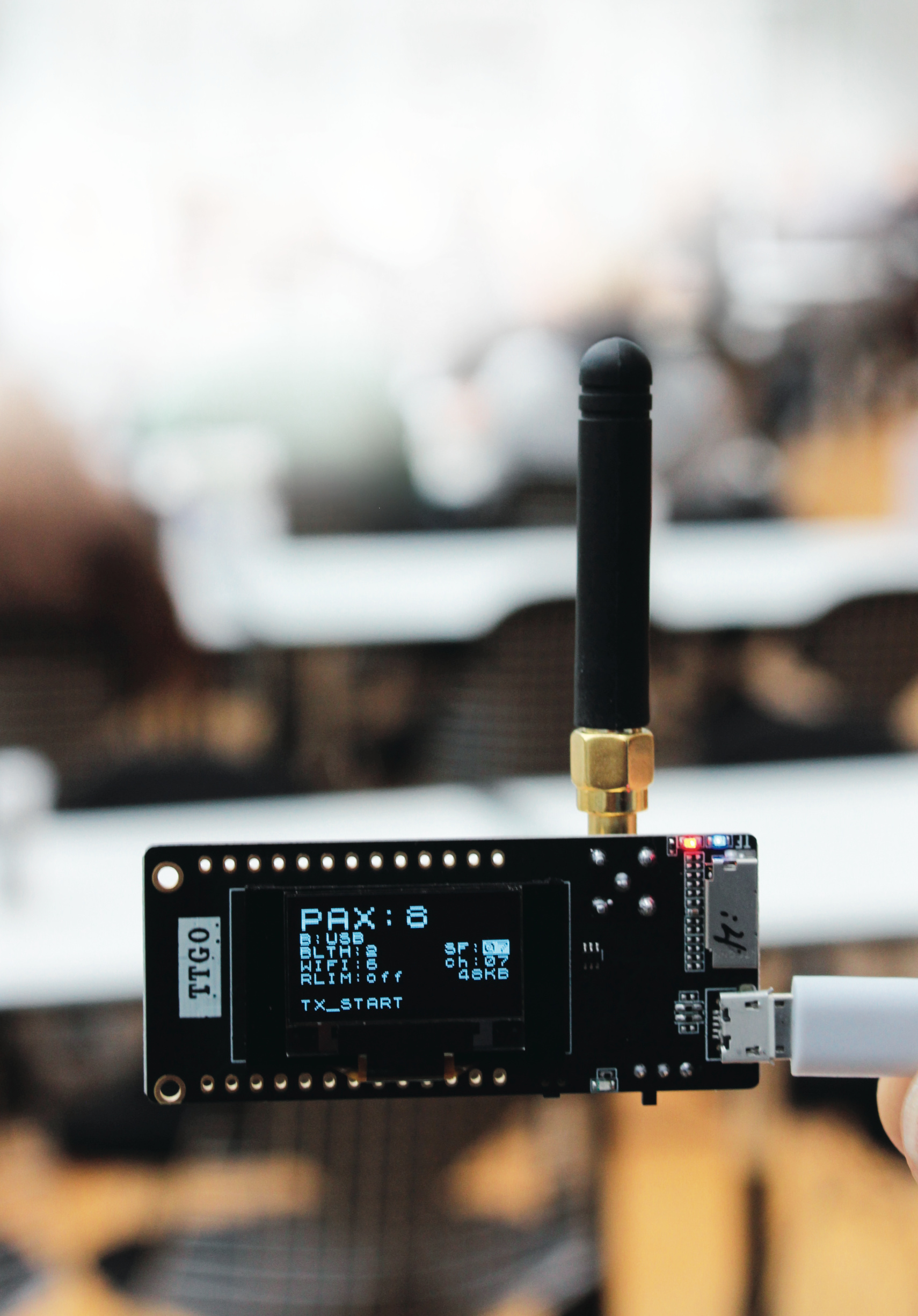

Hi @jpmeijers - mmmh, I’m running unmodified paxcounter source on my TTGO T-Beam Node:
To setup my system I’ve follwed the instructions given by the German Make Magazin:
There are 4 transmissions recorded with RSSIs from -62 to -70dBm:
http://ttnmapper.org/experiments/map.php?name=sensorius-map
I’m clueless how to verify my measurements. Any ideas are appreciated.
However, the GPS position is the correct one.
Thanks for mentioning that the result looks suspicious.
Who is in charge to calculate the RSSI? The RAK 7258 GW I would assume?
