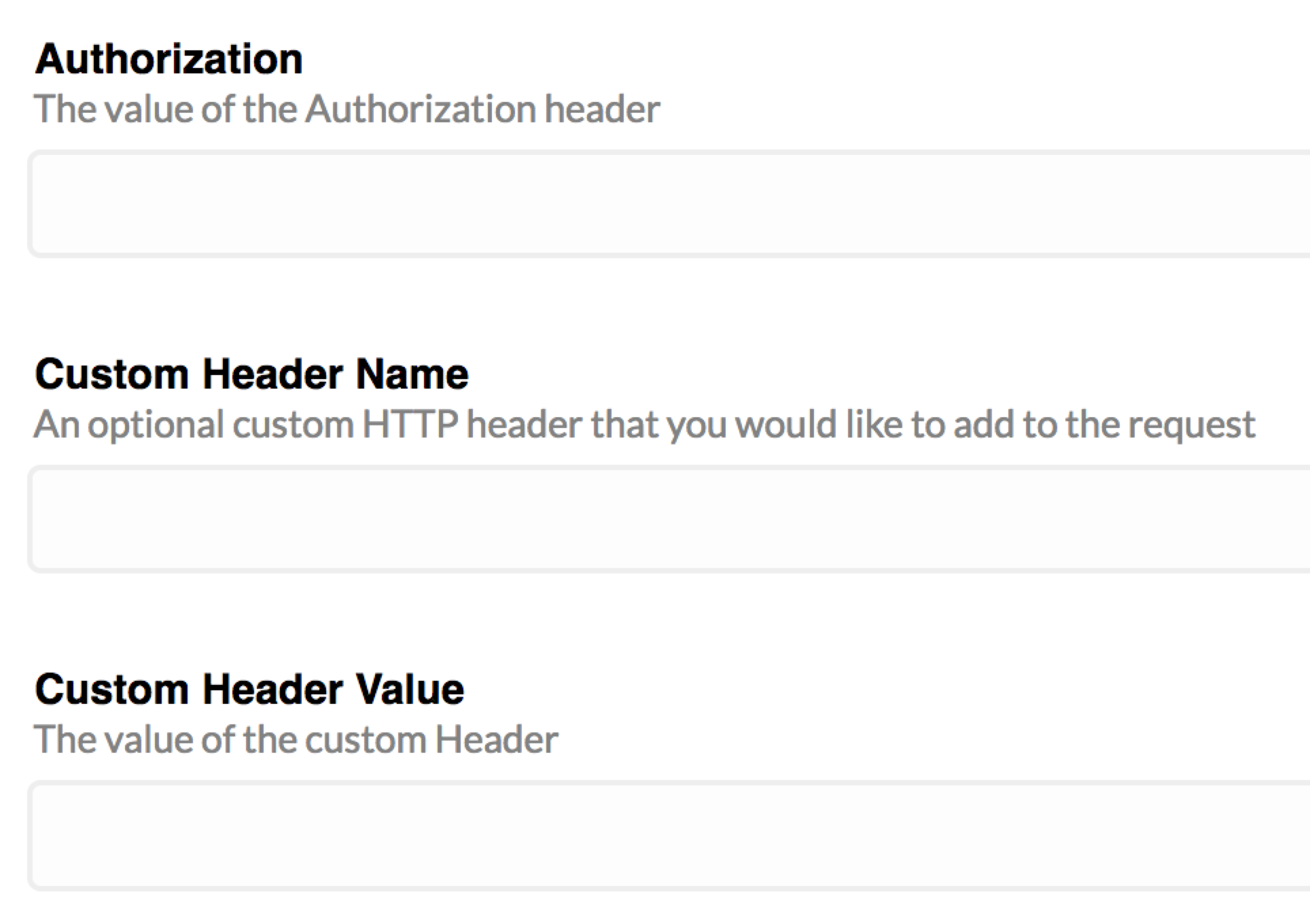

Also, to ensure the requests are really coming from TTN:
  • Set a value for the integration’s Authorization HTTP header (beware that some servers might only support the official Authorization: <type> <credentials> syntax, and might even ignore invalid values when using Basic Access Authentication or Digest Access Authentication; see references in my other answer below). Or add a custom header and a value†, and validate that in your code:
  • Or: add some authentication to the URL (something like ttnpost.php?myauth=my-super-secret)
  • Or: check the key in downlink_url against what you know is correct
  • Or: or use a random URL (like my-super-secret-h7dnt01kqq9.php)
† Added to this answer September 2017; the Authorization header and custom header were added to the integration somewhere after its initial release, and after the initial version of this answer, as posted February 2017.
