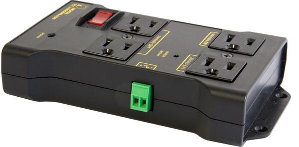

The node ran last night without problems. Previously, I had it connected to one of these:
The Arduino and Dragino shield pair were plugged into the outlet labelled, “Always ON”. The IOT Relay controls a string of lights, and perhaps the voltage delivered to the AC adapter for the Arduino “sagged” under the load of the lights. The node off time was exactly that of the timer settings for the IOT Relay’s lights.
Once I removed the Arduino AC adapter from the IOT Relay and plugged it into the mains, the unit ran all night.
Seems unlikely. If you look at your mains power adapter, you’ll probably see it’s rated for fairly severe undervoltage, to the point where if things were dropping that far, I’d be more concerned about fire risk than LoRa packets.
You might have radio frequency interference from the lights though… or possibly a horrible amount of distortion of the mains waveform from an evil light supply, though I’d expect most switching adapters to survive that.
Are you really sure the times match? The recovery point seemed to be different on different days, and there was the one that didn’t fail.
My actual guess would be that this is just coincidence and the real cause is something else. Note that seeing the problem fixed would not confirm the theory; you’d have to be able to re-create the problem by this method.
Yes. The waveforms are dependent on that day’s temperature, and since those vary, they appear to be unmatched. Also, the middle of the waveform shows no loss of data, and the program I run to control the lights was off that day.
The lights were on last night, but the node was on the mains, not on the relay and I got payloads all night long. So the interference issue doesn’t jive.

The node fails to communicate while the lights are on AND WHEN the AC adapter for the Arduino is connected to the Relay. It was my wild a** guess that the relay voltage was sagging. Perhaps that was a little reckless of me to suggest. Inteference/noise? Perhaps. I’d love to troubleshoot it and really understand. I am not concerned about a fire as the total wattage of the lights is perhaps 500W. I have a watt-meter. I will check that out.
Night 2, Arduino not connected to the IOT Relay, no data gaps. I still have to measure the power draw of the lights. There are 55 of them.
Do you have a way to safely measure the voltage at the power strip when the lights are on?
Something like a Kill-a-watt plug-meter would measure both the consumption and the voltage.
You could also plug in the node’s main’s power supply and measure the output of that while the lights are on…
Thanks - good idea. I have one of those and plan to use it. I wish I had more time during the week. I will do the measurements this weekend.
