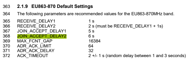

According to the LoRaWAN Regional Specifications:
EU868 Regional Specifications
JOIN_ACCEPT_DELAY2 is 6 seconds.
JOIN_ACCEPT_DELAY1 is 5 seconds.
I’m not sure if latter means exactly 5 seconds or max 5 seconds but max seems most plausable.
In case of max 5 seconds, a 4 seconds delay is valid and in case of exactly 5 seconds, 4 seconds will be too short.
