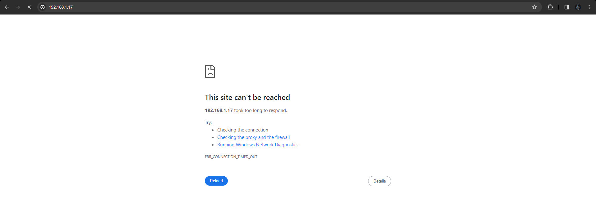

Iād like to ask I got my Gateway and iām having problems connecting to the web interface via ethernet. Connecting through the wifi is working, however I cannot get the Gateway to connect to The Things Stack even though Iām following the steps given in their guide. Iāve tried updating the firmware, but that failed too.
Iāve tried connecting both my PC and Gateway to the router to try and access the interface through https://rg1xxMACID.local (where MACID is the last 6 characters of the gatewayās macid) but it wonāt work no matter what I did.

iāve tried using the IP Address listed in the DHCP didnāt work either. When I ping it it says host is unreachable.

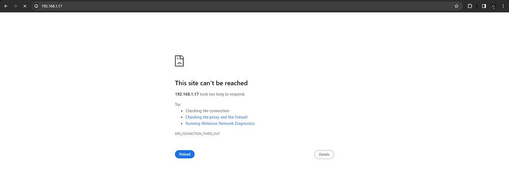

Did this and found out that the IP Address given to the gateway was 192.168.1.17, used that to access the ethernet interface and still no luck.
ā¦and you did that with your PC on wireline on the same router as gave the Laird the 192.168.1.17 address? What is your PC assigned IP address?..
