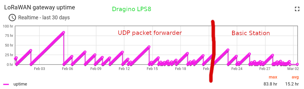

I see a lot of reboots on my LPS8, on average every 15 hours, and Basic Station freezes after a few days/weeks.
I updated it 2 weeks ago with the new firmware (16 Feb 2022 lgw-5.4.1644990565) and configured it for Basic Station, connected over WiFi. It ran fine for 2 weeks (lots of reboots) but froze yesterday. Completely unresponsive, no ping.
I had noticed the same issue on the previous firmware (24 Dec 2021), Basic Station freezing, so I switched back to UDP and that ran without freezing; lots of reboots but always coming back online. I wanted to give Basic Station a chance with the new firmware but it seems to reboot more often, and now it froze.
The only modification i made to the firmware is installing nano and a cron job that sends the uptime over MQTT SSL every 5 minutes. Earlier i had tried to avoid the freezes with watchcat (did not work), and directing the syslog to permanent storage to investigate post freeze but i did not find any errors.
Does anyone have similar reboot/freeze issues with Dragino gateways over WiFi?

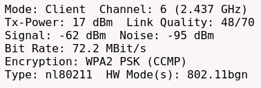

My WiFi signal is not strong, but acceptable?

Your WLAN signal seems to be strong enough, it’s nearly the same signal/noise as I have.

Thanks for the feedback. I’ve switched my LPS8 back to the UDP forwarder and upgraded to a beefy 2.5A power supply, but i’m still seeing several reboots over the past days. I’m just wondering if the same thing is happening to other people without realising it - the uptime is reported in the dashboard bottom right.
gw-uptime
Sorry i didn’t want to hijack this LIG16 thread, just wondering if anyone had a similar problem or if it’s related to firmware. The conclusion seems to be that the LIG16 (both UDP and Basic Station) does not have this problem.

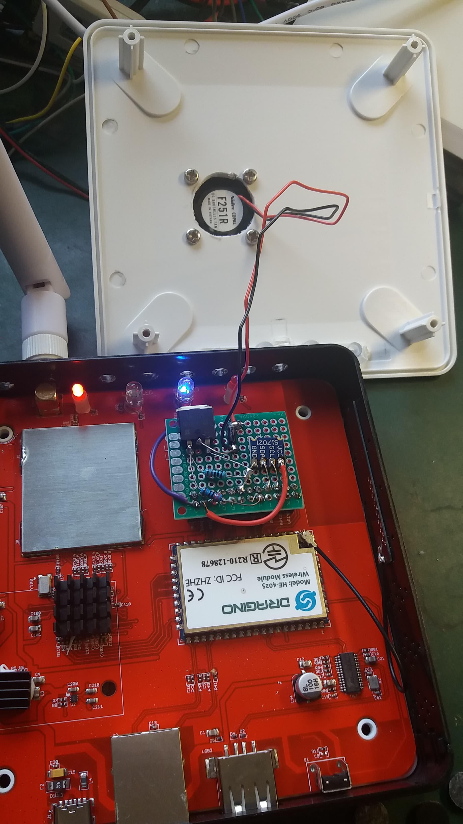

Thanks for all the feedback, i think i’ve figured out the cause: overheating. The LPS8 seems very poorly designed, overheating at around 25 degC ambient air temperature. Maybe not a big issue in Europe but for sub-tropical Hong Kong that it the case more than half of the year, especially under the roof. The Dragino HQ is less than 50k away from here in Shenzhen, i wonder how they test their devices. I’ve added a temperature sensor inside my gateway box, and a small 5V brushless fan that switches on when the inside temp goes above 30 degC (at 40 and 35 degC i was still seeing frequent reboots), and a few ventilation holes in the top panel. Detail here. Almost 4 days without a reboot.
