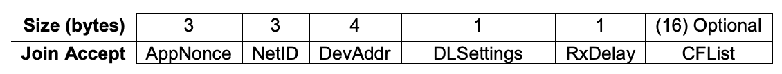

That makes sense: this really is a workaround for the flaw in the 1.0.2 specifications that for US915 do not include the CFList with network settings in the Join Accept. A Join Accept message does not have the option to include additional MAC commands, so an additional downlink is needed, which can only be sent after receiving another uplink:
