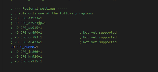

Looks like the node is transmitting.
What region setting is on the node? Check and make sure this is correct. Where I am we use EU frequency band that is why it is uncommented.

Sorry if this is a dump question but where are these settings?
Well I also would use EU because I’m in Germany.

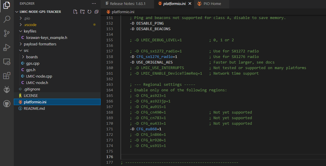

About line 171 in the platformio.ini file
Oh, I see…
I just copied this part from the Internet and modified it,
I’m not having the platformio.ini…
I’m just having the Arduino code I originally posted…
Sorry, my mistake I thought you were using the latest version of Lmic-Node
Where did you download from?
Im using this Library
I guess comment out line 3 and un comment line 2 to get EU operation?! :slight_smile:
