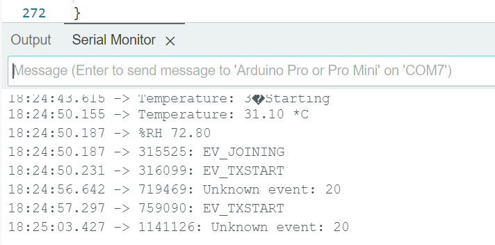

hi! i also have the same problem. i’m trying to send a packet with DHT22 temperature and humidity data to TTN using LoRa. here’s the code i’m using:

however, the output in the serial monitor shows a join and start loop and the sensor can’t connect to TTN.
To get a useful answer you need to be more specific about what “the same problem” is.
One of the instances of the ev_t enum (the one with index 20) is not handled in your onEvent() handler. You should look up the definition of the ev_t enum and find out which one has numerical value 20. Perhaps you can then add a case for it in the onEvent() handler and process the event (e.g. ignore the event if does not matter for you).
