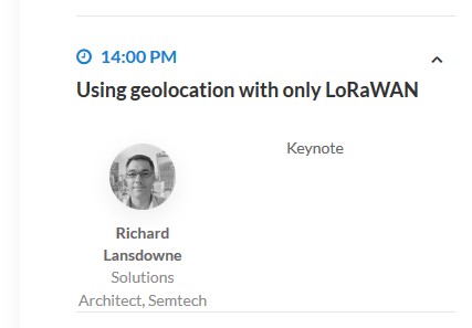

feb1conference
February 1 - The Things Conference
