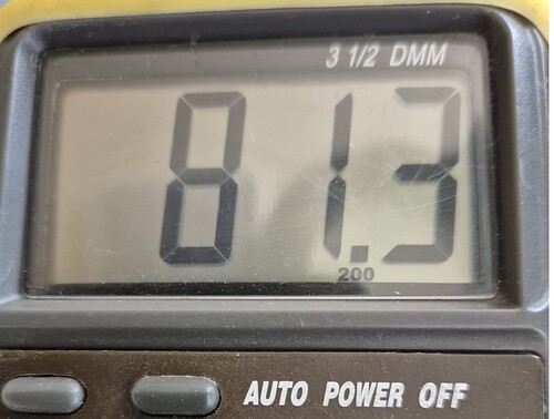

Vutlan LR800 gateway server - 1W consumption. 12V Dc power supply and ~85ma current.
