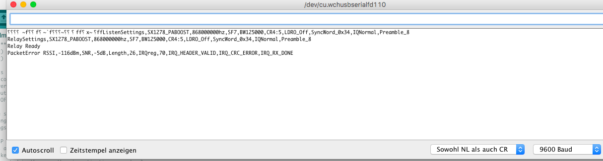

i have test now: sender normal ABP with standart <lmic.h> code to LoraRelay code from @LoRaTracker but both sync words are set to (0x34); then i get in the Serial Monitor of the Relay :
Bildschirmfoto 2021-01-25 um 15.23.19
How close are they? Too close and they will overload the input stages - try to keep them 5m+ apart or behind a wall.
Note, you are NOT sending TO the Relay - the device is sending - the relay hears it, waits a short while and then re-transmits.
As such, this is going to be hard to test because your local gateway will hear the first transmission from the device and then hear the second transmission from the relay. I believe the network server will politely ignore the second transmission so I’m not sure if it will present in any logs on the TTN console.
But it should appear in the gateway log.

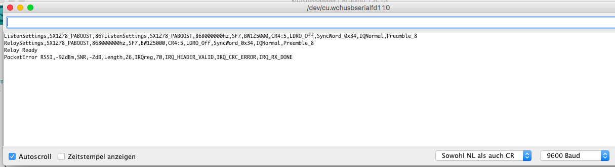

ok, before i test it on my table thats very close. but after your comment i test it in a range about +15meters and the same result. maybe the data is to long ? or what can i am doing wrong?
Bildschirmfoto 2021-01-25 um 15.38.46
The relay is for point to point LoRa, where the same settings are normally used in both directions, uplink & downlink.
