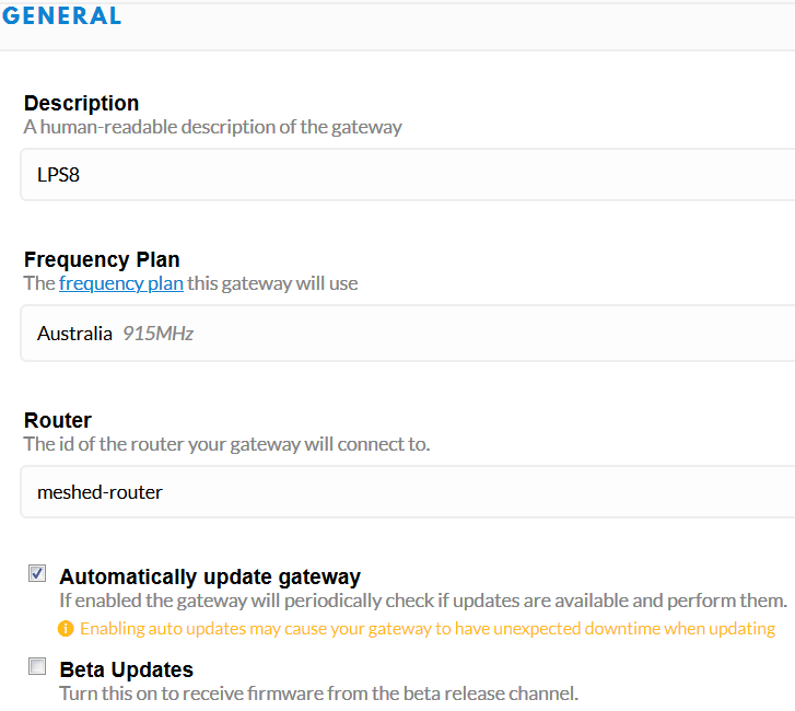

I had tried deleting it and re-registering. Once on www.thethingsnetwork.org and then on console.thethings.meshed.com.au.
I certainly dont see any of those settings from the TTN console:
And the application’s Handler? And maybe you can try ttnctl yourself as well, to see if that gives you different results when not run from Europe?

Note that the above is also lacking the location now (and owner details). Same goes for https://www.thethingsnetwork.org/u/sgrobler Did you set those details to be private? (If you made changes, then maybe that actually updated the details on the other network components, rather than the new gateway firmware?)
For ttnctl gateways status, when invoked from Europe, I still see Last seen: 2020-09-29 14:14:39 and Frequency Plan: EU_863_870 like earlier. But maybe that’s caused by my settings for the CLI, which somehow prefer the EU router? For future readers it may still be nice to see what the result is when invoked by a Meshed user.
For ttnctl gateways info, which already showed Frequency Plan: AU_915_928 earlier too, the location and owner have gone missing too.
Yes I did set those to private. I am fairly convinced it was the firmware that resolved the problem because I had previously deleted the gateway in ttn and re-created it, and it still didn’t work.
