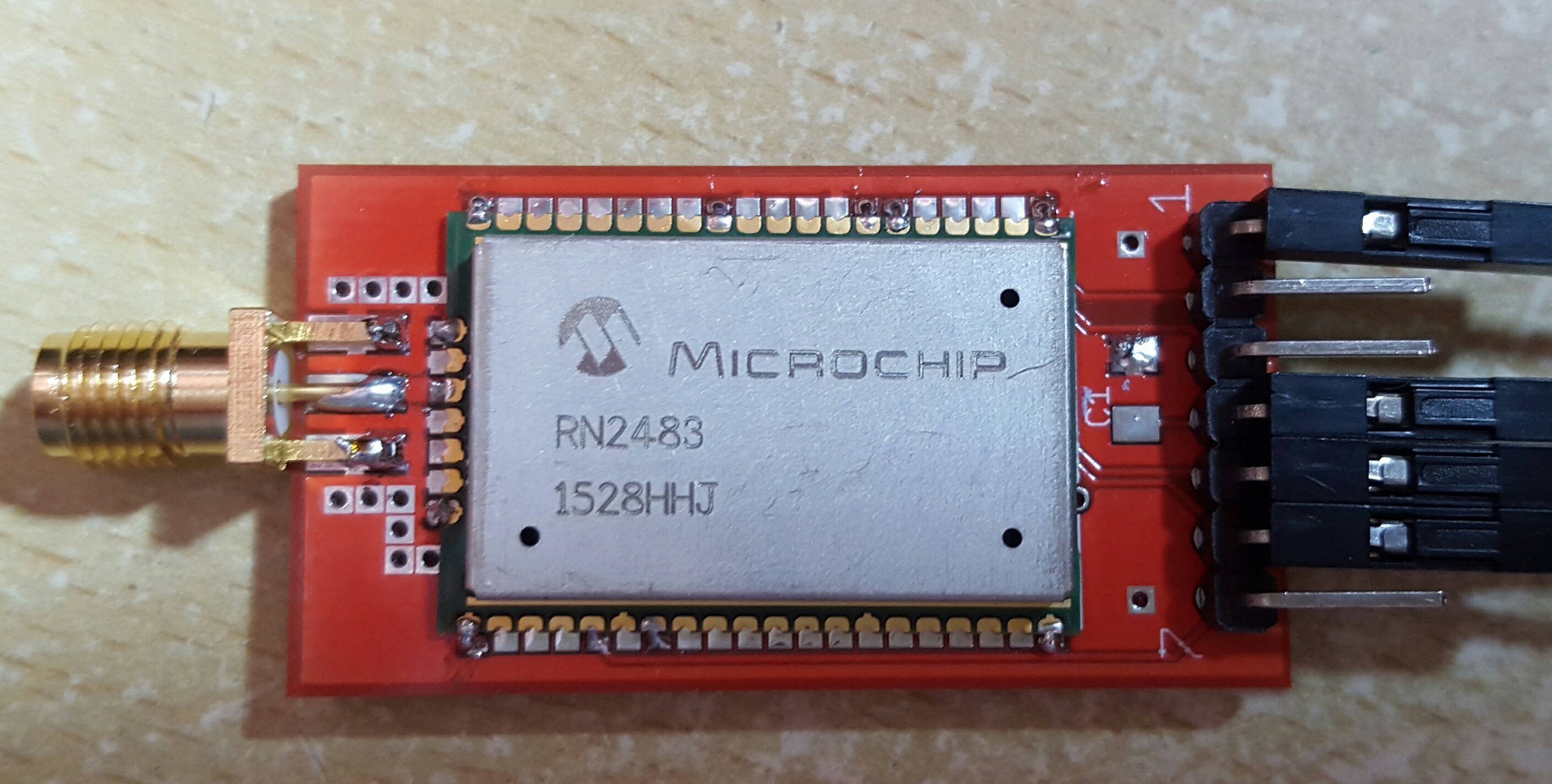

I did something like this:
nice ! Iām not a pcb designer unfortunately ⦠
@thinginnovations thatās pretty cool! would it be possible to share that design somehow? Eagle file or something?
I have a 2nd version Iām getting made. Due to not being able to find a pcb footprint for the RN2483 I had to produce one myself. The pads were as specified in the datasheet but were a little too small to hand solder reliably. If this is ok then Iāll be getting a few more made up and releasing the files for others to use. I wouldnāt want to publish a design that is not usable by others.
Andrew
@thinginnovations: thx, looking forward! Iām in the process of hand-soldering one of these guys and is a pain
In the meantime, this guy from the Espruino community just started selling a breakout board for RN2483 on tindie: https://www.tindie.com/products/DrAzzy/rn2483-breakout-bare-board/
