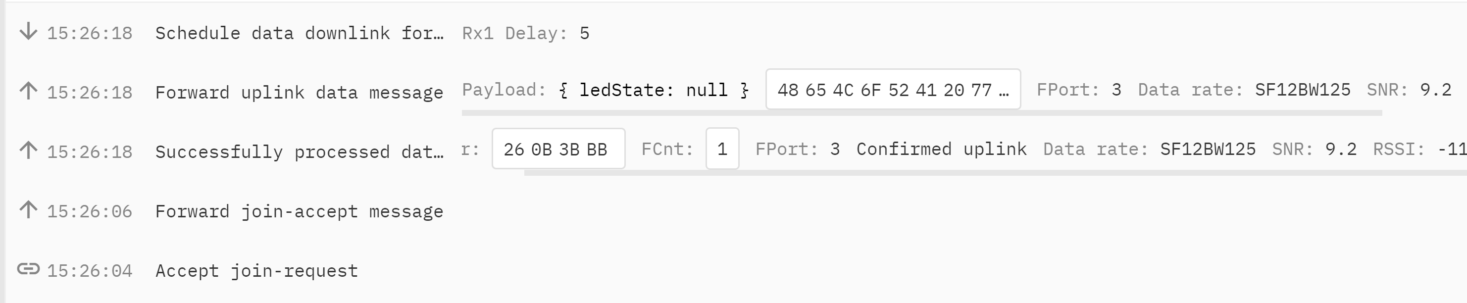

I’ve tried it again, still getting “error sending message :(” on the first configuration example. However, I can see the message it has sent in the Things Network Panel
I find this strange, as I have the payload formatter on so it should decode it. Also, these hex values are no where to be found in the JSON file. I am also wondering what ledState is doing here.
I’m still using the MKRWAN_V2 library, as when doing firmware update to 1.3.0.0, the MKRWAN library stopped working.
