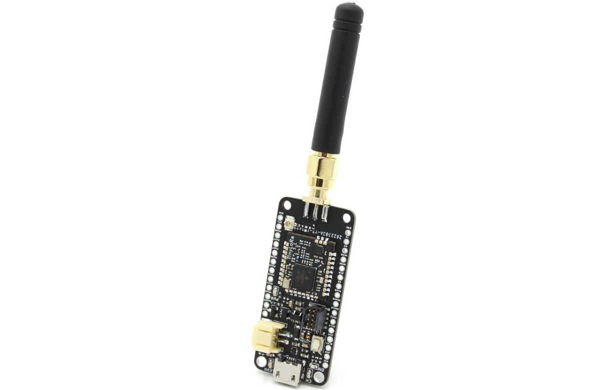

Greeting from Australia Okhan, I just ordered one.
Did you use the Microchip RF reference design which can do both 868MHz and 900MHz?
Have you been able to test the receiver sensitivity to see if there are any anomalies
Regs Joey

Hi, Joey
sorry for the late reply. I just saw your comment.
Yes, I mostly used the Microchip reference design, and it supports both ranges.
Since I don’t have proper RF testing tools, I could only rely on the reference design. So far it seems to work without any issues.
Regards,
Orkhan
