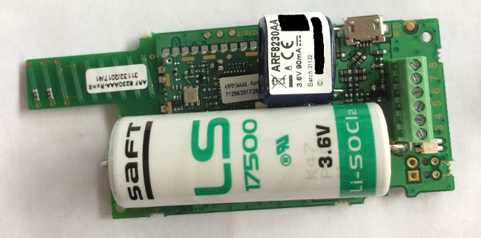

Lately we were testing some Adeunis LoRa units (ADR8230AA).
It is two channels pulse counter, so can be attached to two meters (or one 5 wire meter).
