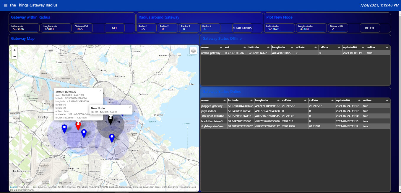

New API for gateway mapping, status and info
A Node-red tool around the TTN Gateway Radius and Gateway API
Added an new table calculating and displaying the distance and azimuth from the new node to gateways.
Also add a window calling on @avbentem airtime-calculator for TTN and a window calling on The Things Network Status Page

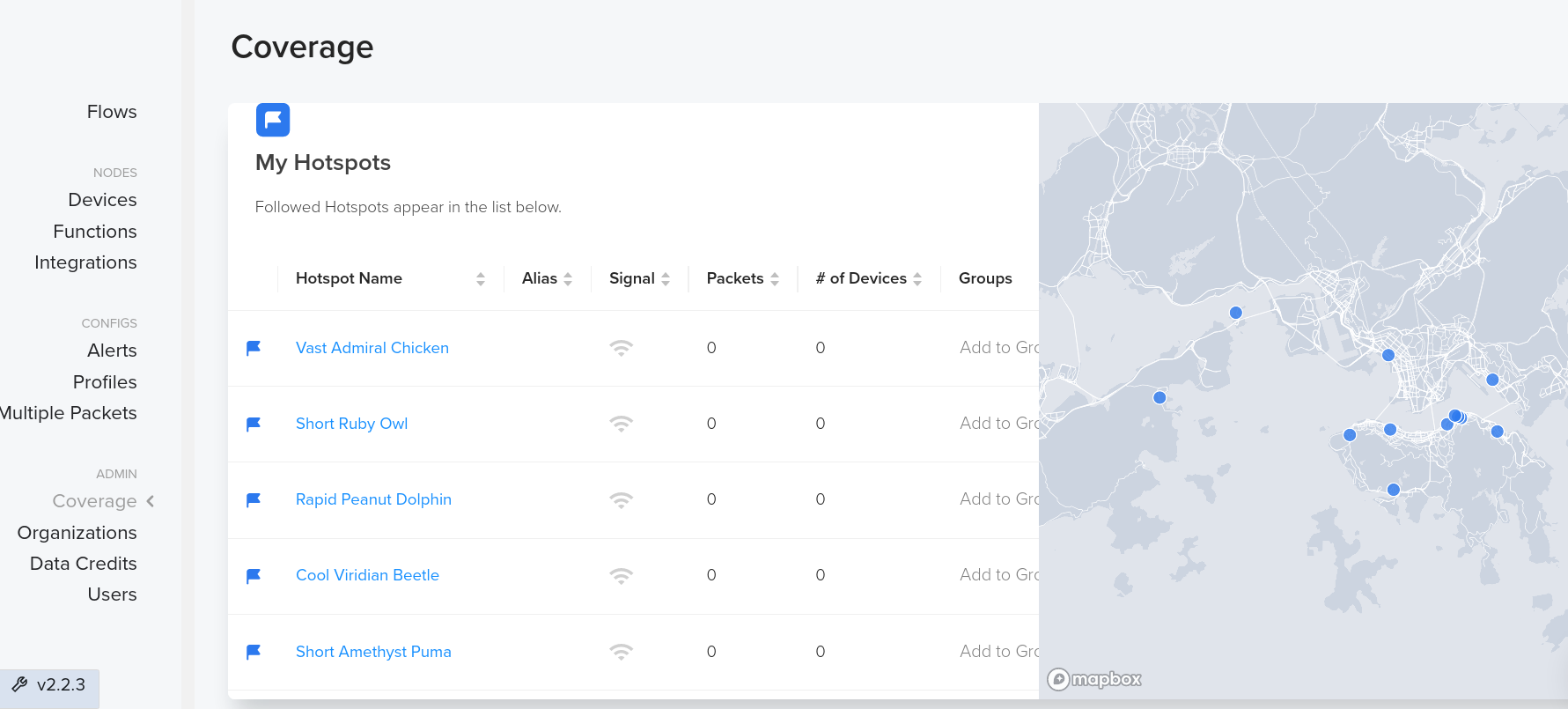

Maybe relevant for this thread; i’ve been trying out the Helium console, and one feature i found useful is the Coverage tab: it allows to list and map all gateways/hotspots that are seeing packets of my devices (no packets in below case because no mapping activity in the last 24hrs)
helium-console-coverage
I think it could be useful to integrate similar functionality in the TTN applications console, to have easy access to a list of gateways serving the end devices and understand on which gateways the application depends. I see that the rxmetadata has the gateway info, so it would seem easy to extract it and keep a log of the gateways, packet counts, and show a map.

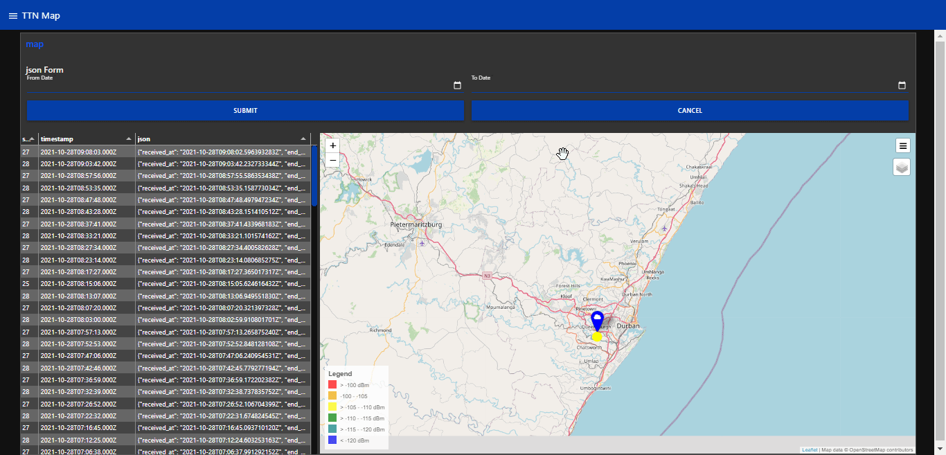

Very easy, you can build your own.
Store all you uplink information, including gateway information in a DB, then you can just recall all the data for the time period you require an display your nodes and relative gateways on a map.
Demo TTN Node Map

I actually need to re write it to use oraclecloud - But here is the AWS version.
